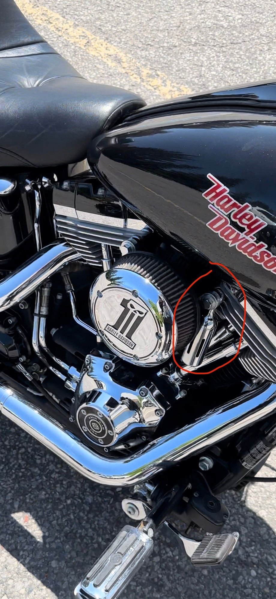

Hey everyone!
Just picked up a 2011 Harley Davidson Blackline. Came with a few extras already installed and I’m about to do a full 3 hole oil change on it - However, i’m curious to this catch can? I haven’t seen it after scouring online for a few hours. Can anyone help identify it/provide some advice on how to clean/maintain it?
I ask because on my ride home from picking up the bike, i noticed that there’s some smoke coming out of these cans when stopped at a light. I’m assuming it could be an overflow of oil that’s getting heated up by the engine?
Thanks all!

Now that's a milker if I have ever seen one.

I don't think you should be seeing that much "smoke" coming out of them. But if smoke is coming out, it would be an oil mist.
If you are seeing that much mist, there may be something wrong with your engine...

I've seen adds for a couple kits like them before.... But I have never seen them in person. If I can find an add, I'll post it up...
It's possible they just need to be emptied and/or cleaned out. Some people add catch cans then just forget about them.
Found them:
https://www.jpcycles.com/product/sif...xoCUDQQAvD_BwE

I commend your searching. I looked for what feels like hours haha. Okay, so this will give me a bit more insight as to how to maintain them.
As for the smoking, i’m hoping that it’s not something more serious…
Thank you!

So it looks like it’s more a breather than a catch can. Should I be concerned if I find oil in these? Took a napkin and noticed a few drops oil seeping out of them.

Really no concern about a few drops of oil. But if there is a lot of oil, or again, lots of visible mist all the time, there may be an issue with the engine.

But each Twin Cam is different. Some have more general blow-by and/or breather bypass that others. Running the oil level at the full mark and then running the engine hard seems to be a recipe for more, rather than less, breather system mist/oil...
If you have the tools and the time, you could always run a compression and then leak down test if you suspect something is amiss...

Just looking at the design and layout of those makes me think right away - Oil breather mist = mess. They are below the breather bolts and oil is going to gravitate down no matter what.
It's the engine's breather system to relieve pressure - It is going to have some oil misting. I would consider a different setup.
I made a "T" of the two hoses and ran it up to the main frame and then looped back behind the battery and down. Then any slight oil that forms in the hose can run back into the engine. Did the same on my Triumph twin. Seems to work fine, no mess.
