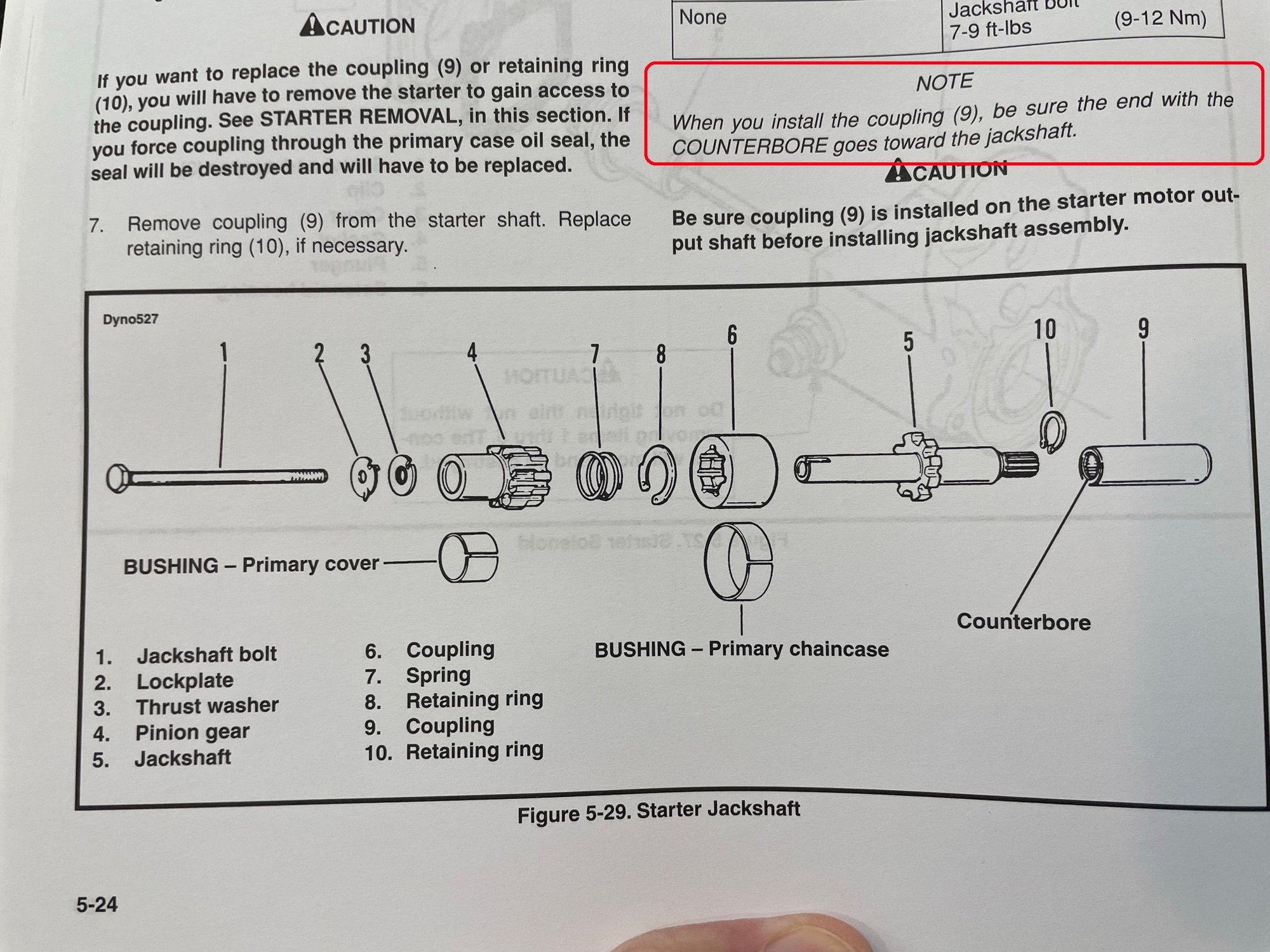

I don`t see the coupling (item 9).
Old Jul 18, 2023 | 01:31 PM
mikey95hd's Avatar
mikey95hd
Joined: Jul 2023
Posts: 143
Likes: 22
From: California
It's installed on the starter motor, and I'm sure it's installed properly, the counter bore is facing outward towards the shaft.
