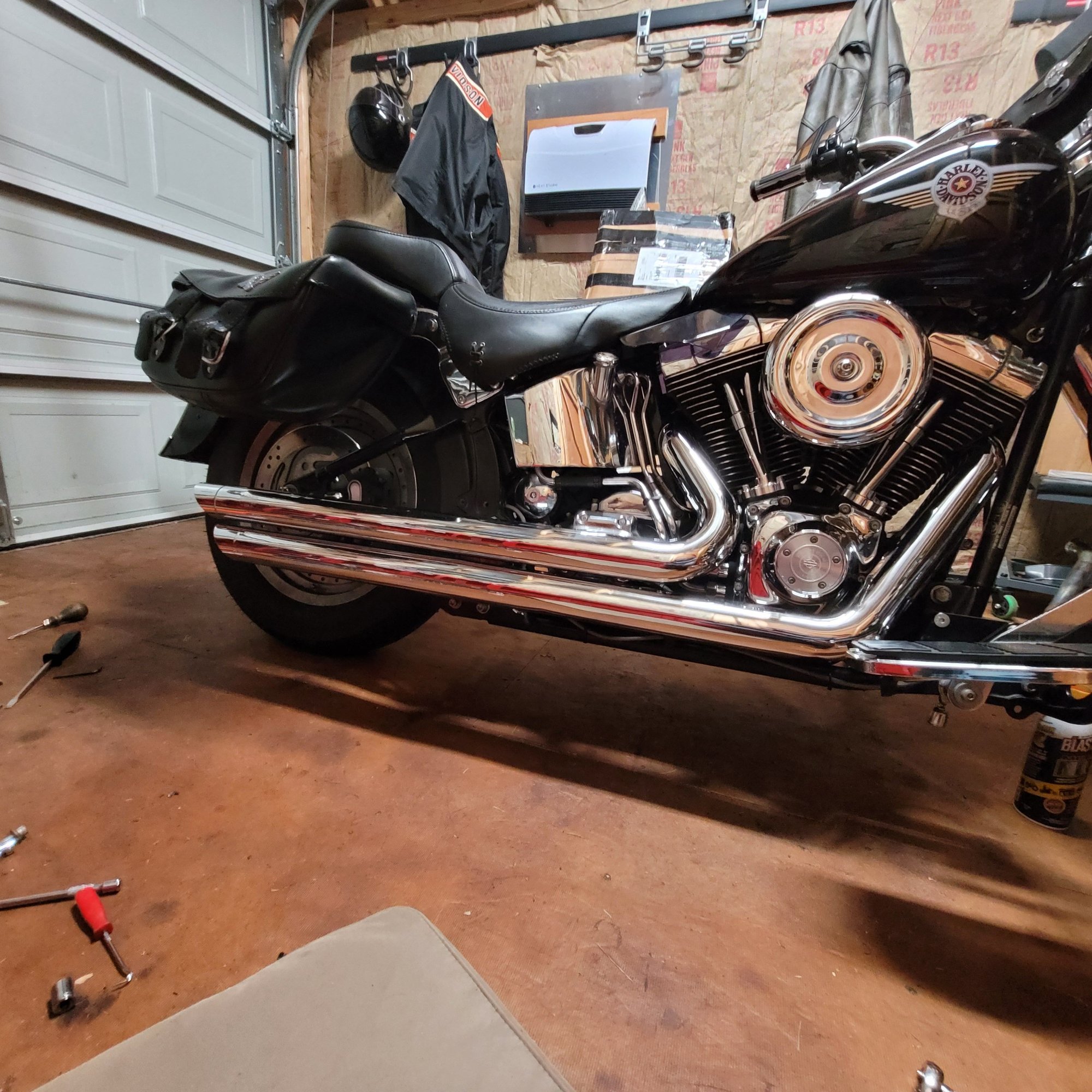

The answer is yes, they fit perfectly. The most difficult thing was putting on the second exhaust tip! I got a great deal on the pipes....1 year old for $160.00! There was no way I could pass it up. There are a few small dings in the heat shield, but nothing more than would appear from typical use.

Looks good....
Did you have to modify the bracket at all... or did they just bolt right up...?

The bracket lined right up. No mods required.
