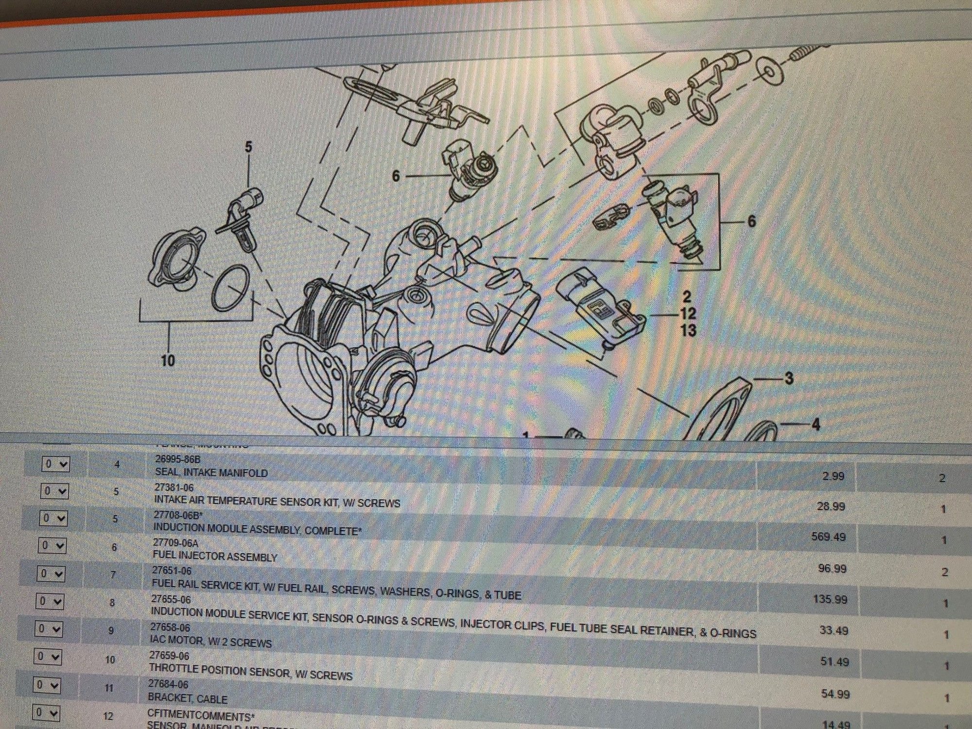

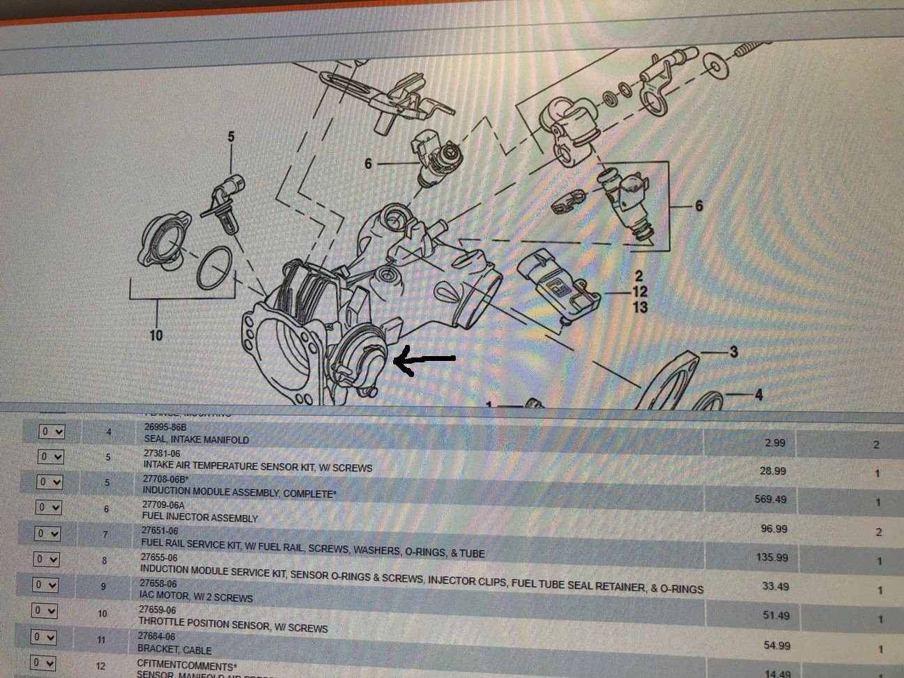

Throttle is VERY stiff, no spring return to idle. I think its the part on the side of the throttle body where the cables attach. Is this part replaceable? What is it called?

I will check that. The part I am talking about appears to be attached to the induction body. It makes a soft ratcheting sound when I move it by hand (no cables on). Guess if its broke, its the whole induction body that has to be replaced?

Based on the parts finder, it sure looks that way... not cheap either.... but at least it's still available...
I saw a used one for like $149 on eBay.... but there is no guarantee the cable actuator on the used one isn't worn or ready to break...
Check the couple of suggestions given above first.
Just prior to buying a new one, maybe see if it can be taken apart and cleaned...? Your year has a plastic cover, but my '03 EFI cable control is held onto the throttle body with an e-style retaining ring.
