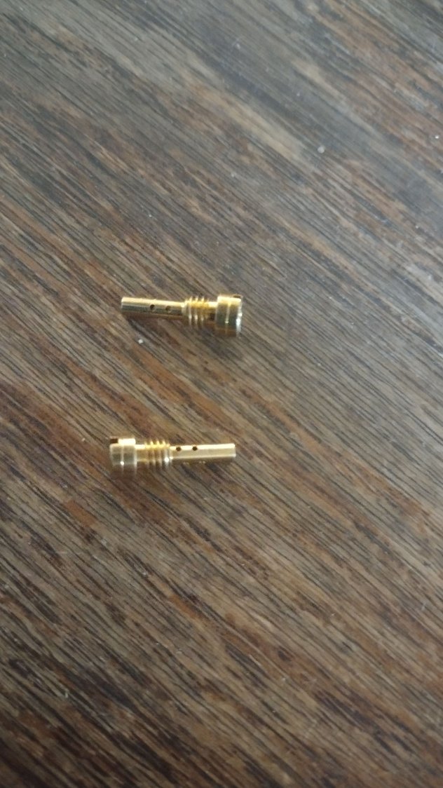

Ok I just noticed in the box the after market carb came in is a little baggy with a bunch of jets different sizes
THey look like needle jets.and they have numbers on them.
Is it possible one of these is what I need to put in carb
I'll get my magnifying glass and post the numbers on here
These have 40 or 48 hard to read and 42 on them
These are 80 85 and 90 other looks like some kind of plug and a rubber piece

The carb for your bike in OEM form takes a #42 pilot jet (slow jet).
Could the others be 180, 185, & 190...?
If so, they are the main jets, and 180 is what you want for your bike in OEM form...
There is an exploded diagram on the CV Performance web site that will show you where everything goes...
I'd still rebuild the OEM HD CV40 with dependable parts, rather than trust the Chinese carb/parts...
