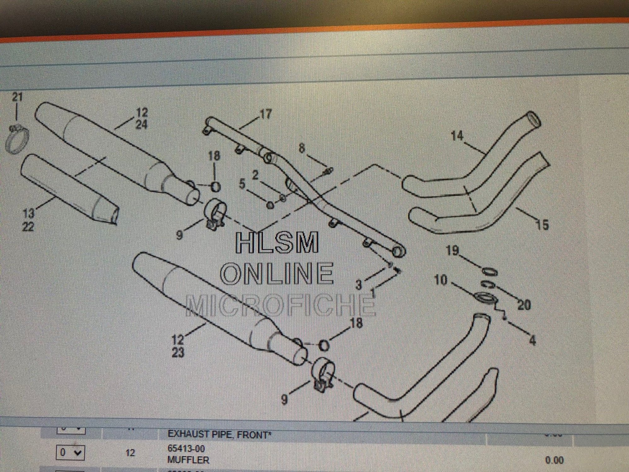

Hard to guess from here w/o a picture
Typically it`s just the mufflers not the headpipes
Easy enough to swap back to stock esp if the ones
you find include the interconnect tube/ mounting bracket ( item #17 in pic )
I suppose you could plug or weld the muffler ports shut

Thanks. I have that interconnect. Is there a different one for the stock pipes?
The one pictured IS the stock part
Ah, OK. Got it. I'm going to assume the interconnect fits both. Mine looks the same as the picture. Thanks for the help.

Parts fiche for your bike show both front & rear muffler being identical
#65413-00
the 65842-00A is a catalyst muffler for export
In the ad they do not appear to match.
Note the angle of interconnect "stubs"
I`d pass

I am assuming your bike was originally sold in the US. If so, your VIN will start with "1HD". I would contact the seller before making the purchase and make sure BOTH mufflers are part #65413-00....
Per the HD online parts finder, the 2003 Heritage Domestic models sold in US, use two #65413-00 mufflers.
That eBay add says "65413-00 65842-00A". The muffler part #65842-00A is the front muffler and part #65885-00 is the rear muffler on the HDI (Harley-Davidson International) models, sold outside the US...
I have no idea what, if any, difference there is between these domestic and international mufflers... but #65842-00A is not the same part number as the Domestic models use....
It's possible the seller doesn't understand the part numbers himself, but IMHO, I wouldn't buy a muffler that wasn't guaranteed to be part #65413-00 if you want OEM mufflers for your bike....
