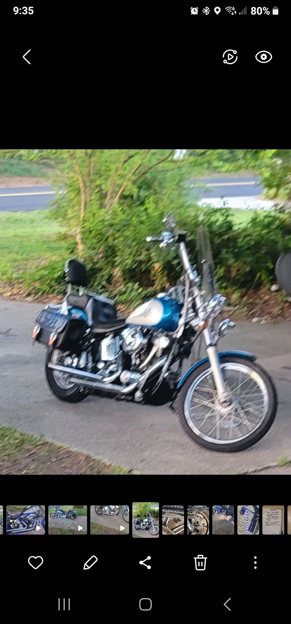

Old Nov 11, 2023 | 08:37 AM
Cloudshaker's Avatar
Cloudshaker
Joined: Nov 2023
Posts: 18
Likes: 6
From: GA
95 Softail Custom
