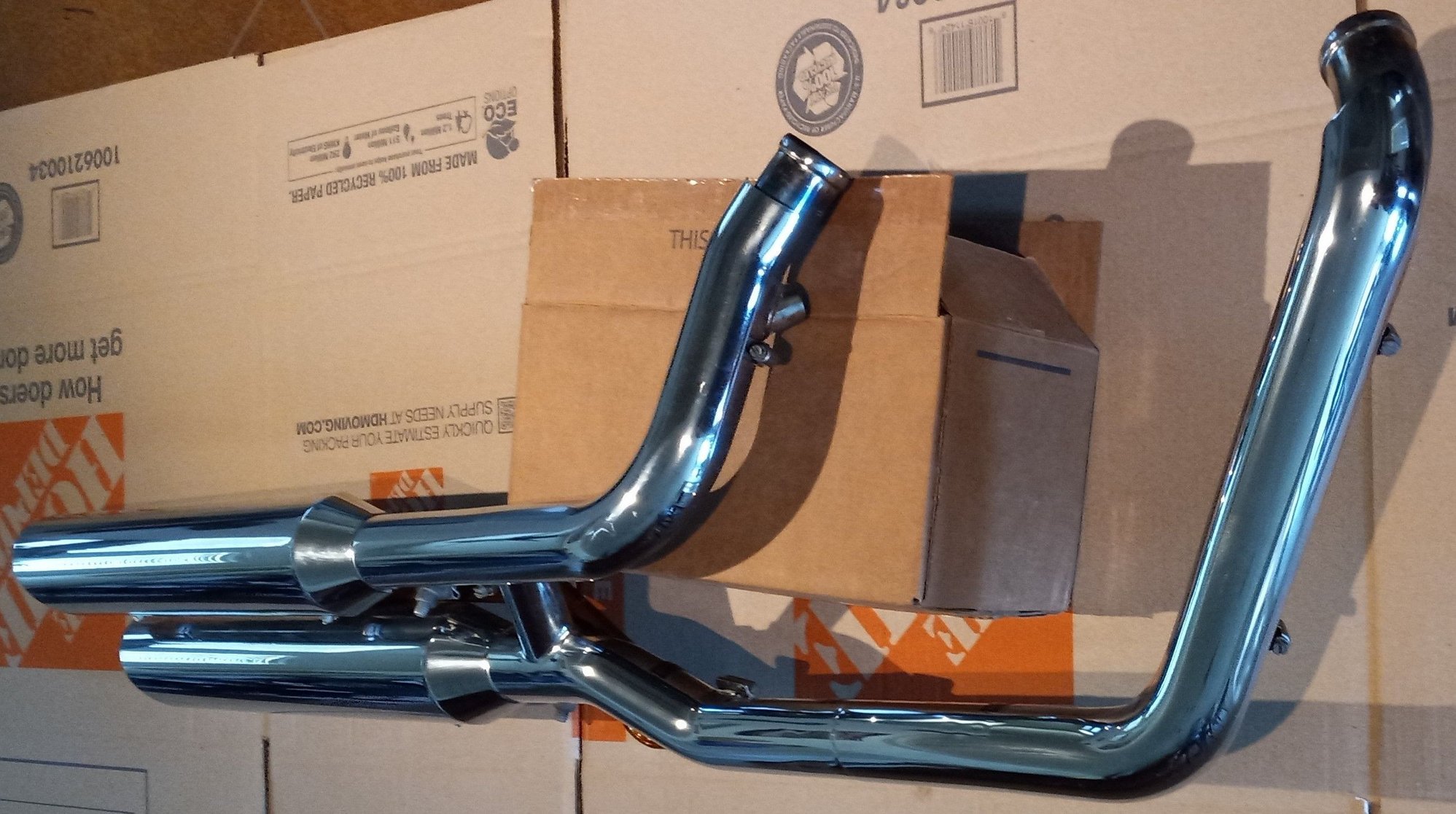

I took the vance and hines pipes off my 2008 cvo so i could put the original pipes back on. The wire to the sensor kinda just flopped out and came with the pipes as i was removing them and i thought it just unplugged by itself., no big deal.
so now when i was gonna put the original pipes back on i located the wire to hook the sensor up and i notice it is "Plugged" with some sort of plug, so it was not connected in the first place.
so now i am wondering what i should do, since i have no idea what this plug thing is. anyone else come accross this? thanks in advance. (PS I bought the bike used and the previous owner has no idea.) ( I also seen i wring diagram that shows only the front oxygen sensor. And Even stranger is i have another bike (exact same year and model that has different pipes and there are no sensors at all, and that bike runs great)

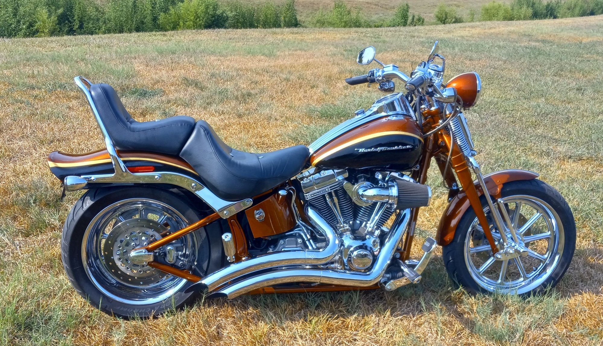

Nice bike though.. Should sell rather well.. CVO Softail Springer... Nice..

its not "my" tune. but i am curious about it. someeone before me did some half assed stuff i guess.
BUT, the bike was running good.
I have no idea why they did this. i will put the original exhaust back on and see what happens, and go from there.
i asked the guy that sold it to me if the pipes had baffles when i first saw it. he said he didnt know. he was clueless. i bent down and looked and saw the baffles. he said he bought the bike to impress the ladies, but now he was too old and wanted rid of it. he probably never rode it more that 5 miles at a time.
as i said, i drove it once, about 15 miles and it drove great, i would never have know something was amiss had i not taken the pipes off.
from what i gather, to properly tune on eof these can be quite expensive.
i would "guess" it was never "tuned". someone probably changed the pipes and disconnected the rear o2 sensor and said thats good to go.
all i am probably doing is putting it back to the way it left the factory, and that good enough for me, since i am selling this one. the original exhaust i have looks like it is brand new, and the seat i have for it was never used.

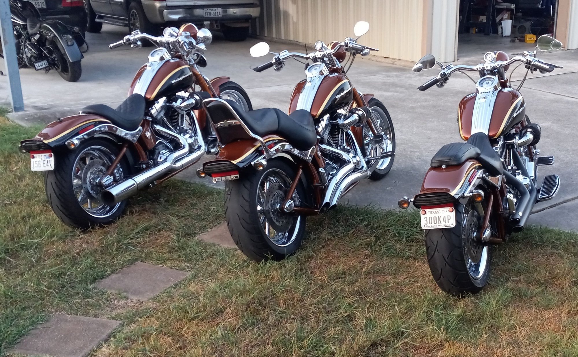

the other one i have has the vance and hines propipe, and it has a usb plug under the seat, and NO O2 sensors whatsoever and it runs like a scalded ape.
the bike only has 14,800 miles, so if anyone want one, heres your chance, i just want to break even.

I put the original exhaust back on, left the rear o2 sensor disconnected. took it for a short ride and although very quiet, the bike ran fine, no issues, and no faults light came on. there is zero point in me getting a tune for the bike now. the next owner will no doubt remove the original pipes and he can tune it up until his heart is content.
thanks for the education on the o2 sensors, as i said, its the first time i ever messed with them.
