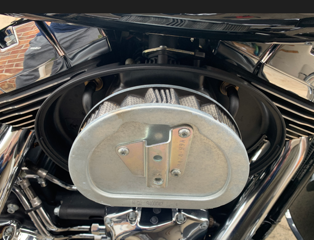

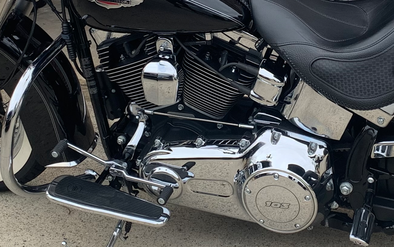

Guys,
Just bought a 15' Softail Deluxe 103B. VIN# is 1 H D 1 J D V 1 8 F B 0 2 0 7 3 1.
I bought Donny Peterson's book, and he shows how to decipher the VIN number.
Accordingly, the "JD" translates to a FLSTNI Softail Deluxe EFI. (note: all my financial and insurance documentation shows "FLSTN"....not "FLSTNI".)
Furthermore, the "V" in the VIN translates to a 1999-2006 Twin Cam TC88A Carb. So now I'm confused.
Please see photos.....is this EFI or carbureted? I see no petcock on the left side of the engine.
THANKS GUYS !
Lance

Your bike is fuel injected.
Look at the fuel tank connection on the left side, just abaft of the horn. That's the fuel injected quick release.
Look on the right side, just inboard of the air filter housing. That's the top of the fuel injection unit.

The fact that the bike doesn`t have a carburetor is a dead giveaway that it is fuel injected.

Looking at this I couldn't tell !

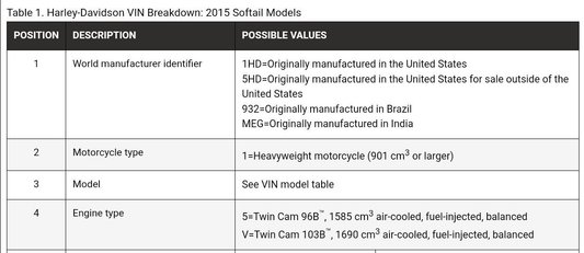

What was the copyright date on your Donny Peterson book?? I suspect that published VIN decoder is not updated, or has typos..
Just FYI.... Since you asked about the discrepancies, and to satisfy your curiosity....
According to a vin decoder I checked:
Engine displacement designation "V" = "Twin Cam 88 carburetor, 103B"
The comma shows a break between two different items... That code can be one of two different engines. You have the second one listed "103B", or otherwise stated a 103" B engine. All 103" engines were EFI from the factory, and all Twin cam softails have a "B" engine, meaning a balanced version of that Twin Cam engine.
It's just like your year code: F = "1985, 2015" . That code stands for two years, like your engine code stands for two engines.
NOTE: I see some decoders show "V" = "Twin Cam 88 carburetor, 130B". Since there is no factory installed 130" B engine, I'm guessing that is a typo that should read 103B
As to your bike being an FLSTN:
Harley only referred to EFI bikes, by putting an " i " at the end of the model letter designation, when there was also a carb version offered. Once Harley went to EFI only throughout the model line in 2007, the " i " at the end of the letter designations was dropped.
So your 2015 Deluxe with EFI is appropriately referred to as only a "FLSTN", since there was no carbureted Deluxe models in 2015.
Hope that satisfies your curiosity...

The owner's manual has a VIN breakdown.
