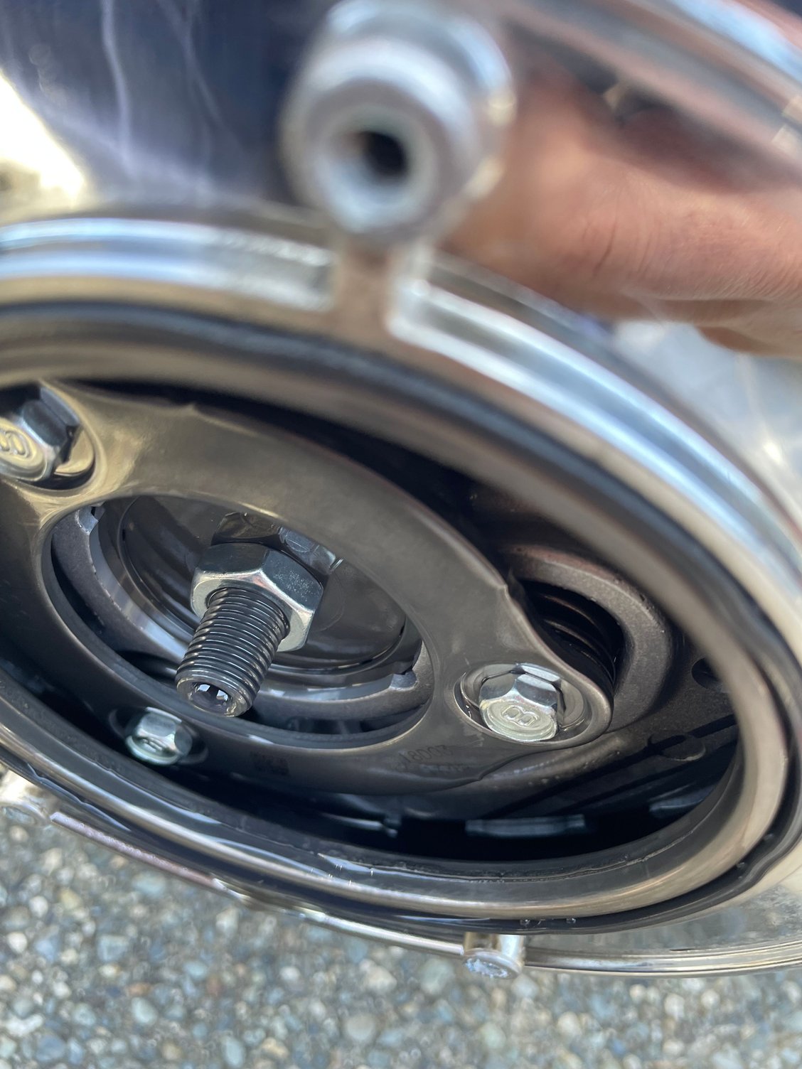

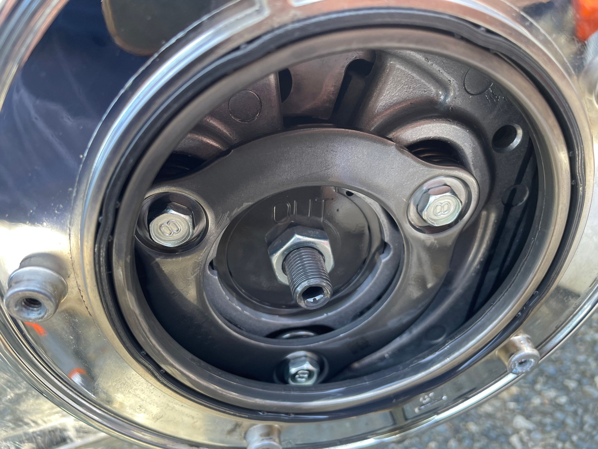

So I just re checked. My engine oil is still much higher than supposed to be. My primary is definitely low.. so my guess is a leak.. does anybody know how much of a job this is? I’m no mechanic by any means. Labour and parts estimate? Always something with these M8s haha. Thanks for everyone’s input it’s appreciated. Going to the mechanics next week to a get a full overlook.
