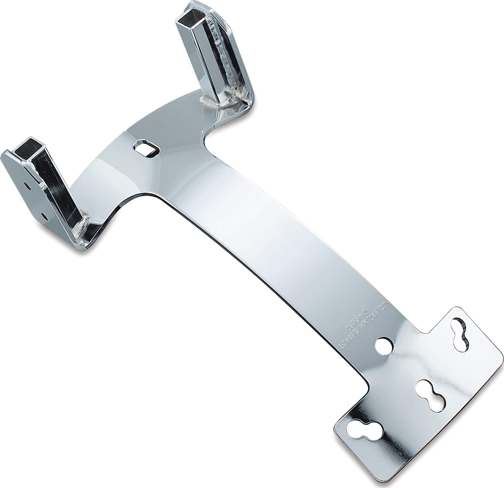

I modified this to add a sissy bar to mine
Amazon.com: Kuryakyn 8998 Motorcycle Accessory: Plug-N-Play Sissy Bar Component, Mount for Harley-Davidson Softail, Dyna, Sportster, FXR Motorcycles, Chrome : Automotive Amazon.com: Kuryakyn 8998 Motorcycle Accessory: Plug-N-Play Sissy Bar Component, Mount for Harley-Davidson Softail, Dyna, Sportster, FXR Motorcycles, Chrome : Automotive
It needs modified/cut and drilled to fit.

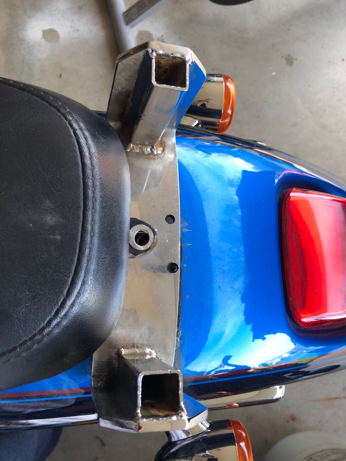

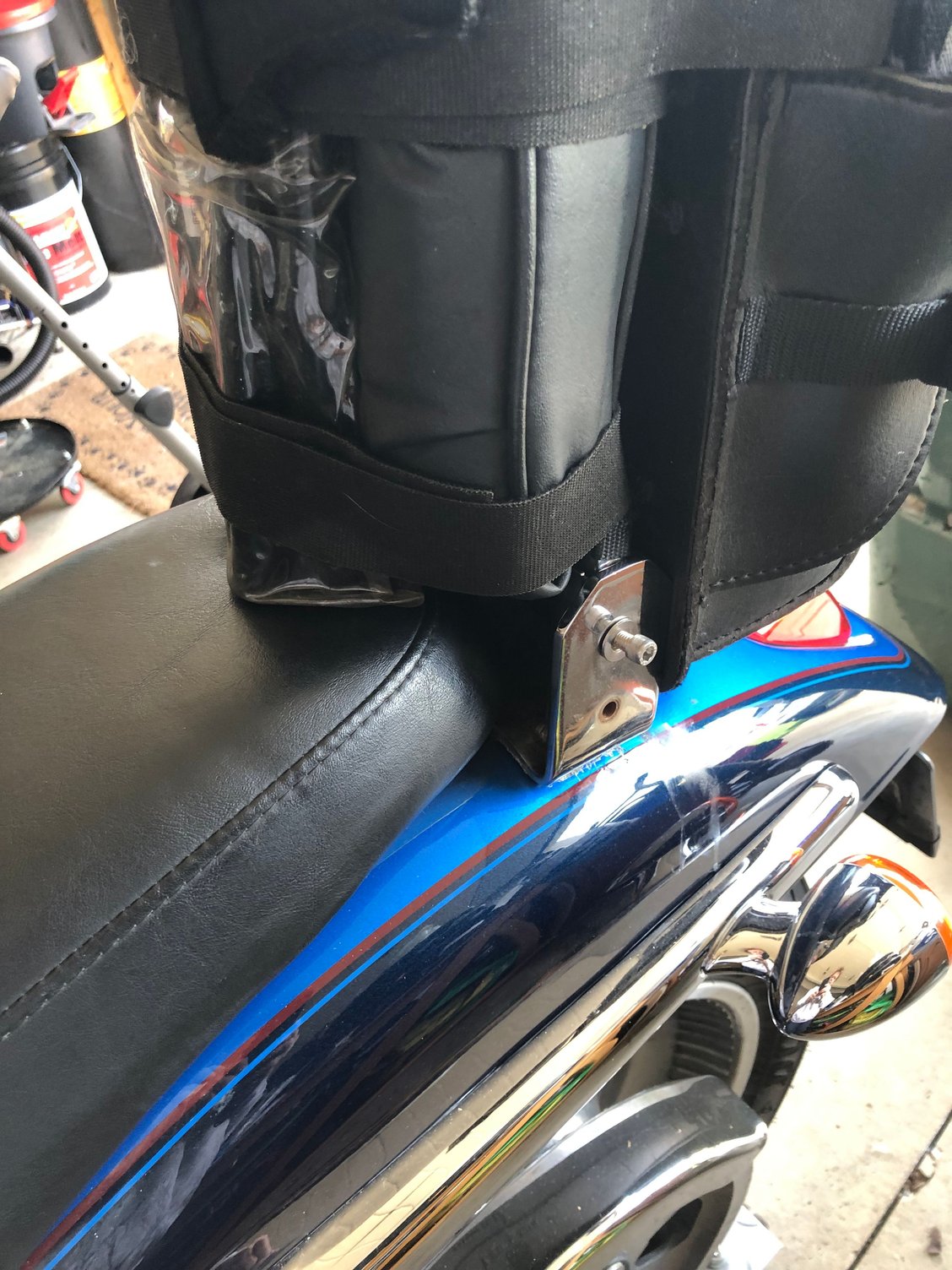

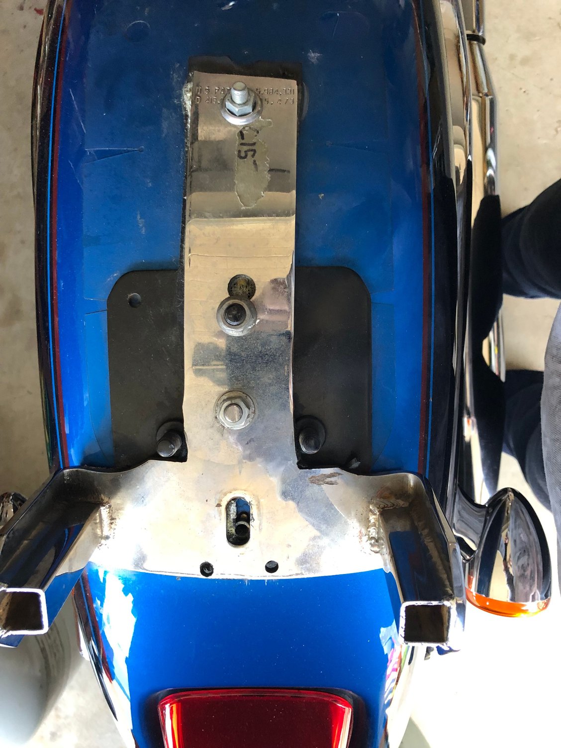

Here's how i did it.
Note, I don't know right way or the wrong way
Just "my" way amateur hour
I forget why I cut as much off the front of the bracket as I did.
But recall I had to cut some off
I drilled three holes in the bracket
Two new bolts and used one stud from the oem back rest plate.
Had to do some grinding for the bracket to clear the two back rest bolt/studs
when locating drill hole, have to make sure the slot hole at rear allows access to seat bolt
I ground off the seat screw and replaced it with a longer stainless screw with #3 Phillips pan head
the sissy bar came with phillips head screws
I replaced them w/stainless cap screws due to rachet ease in and out
(have to remove sissy bar anytime I need under the seat)
I discovered phillips can't get tight enough to not vibrate loose without locktite
..L.T.A.
