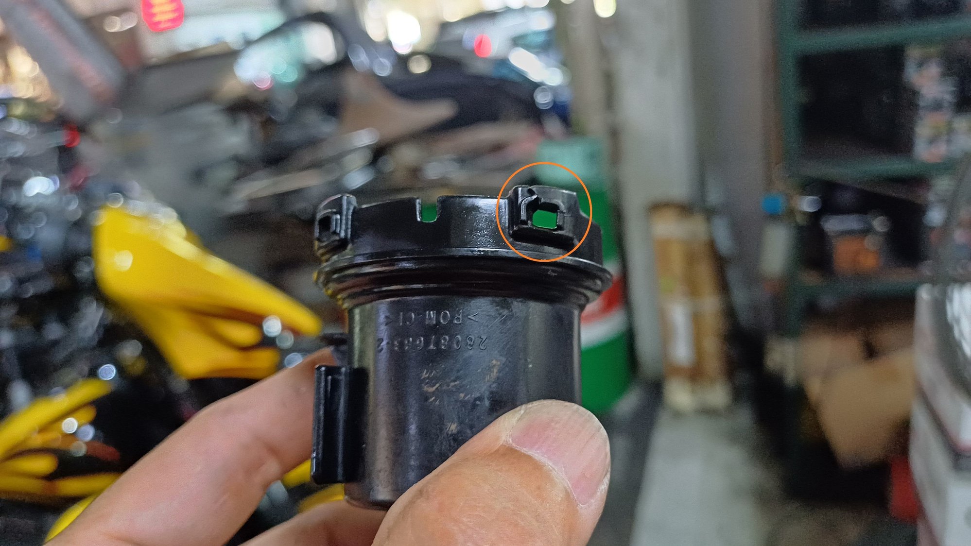

This is the plastic housing.
Ok , And where do I find that ? Or what is it attached to ,so I can some day find it .

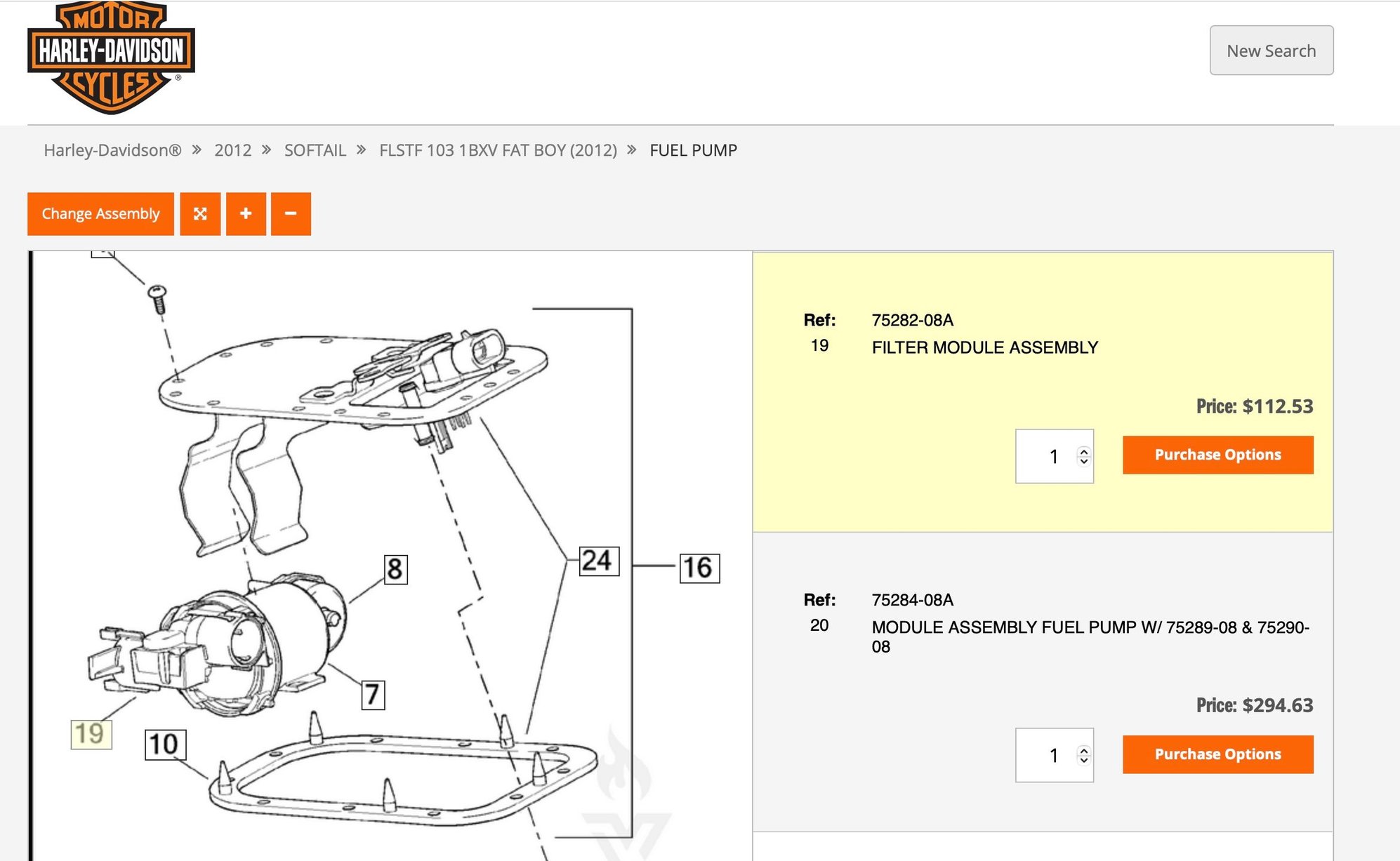

I believe this should be the one.
75282-08a Harley Davidson Fuel Filter Module Assembly
I have no idea if you can just get the housing only. I am also keen to know if the housing is available separately.
I just noticed you have a newer Twin Cam... The Trask billet regulator housing I mentioned earlier is for the older Twin Cams. 88" Twin Cams had the issue with the plastic regulator housings cracking & leaking a lot.
I was unaware it was also happening on the newer 96" & 103" Twin Cams.
I am also unaware of anyone making the regulator housing separately for the newer Twin Cams... I believe it is only available with the "Filter Module Assembly"..
Someone who knows more about this than me, will surely chime in if I am mistaken..
