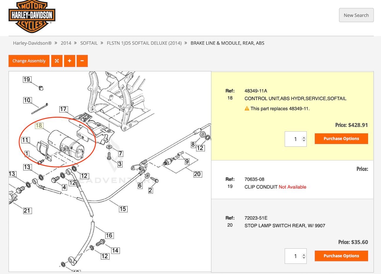

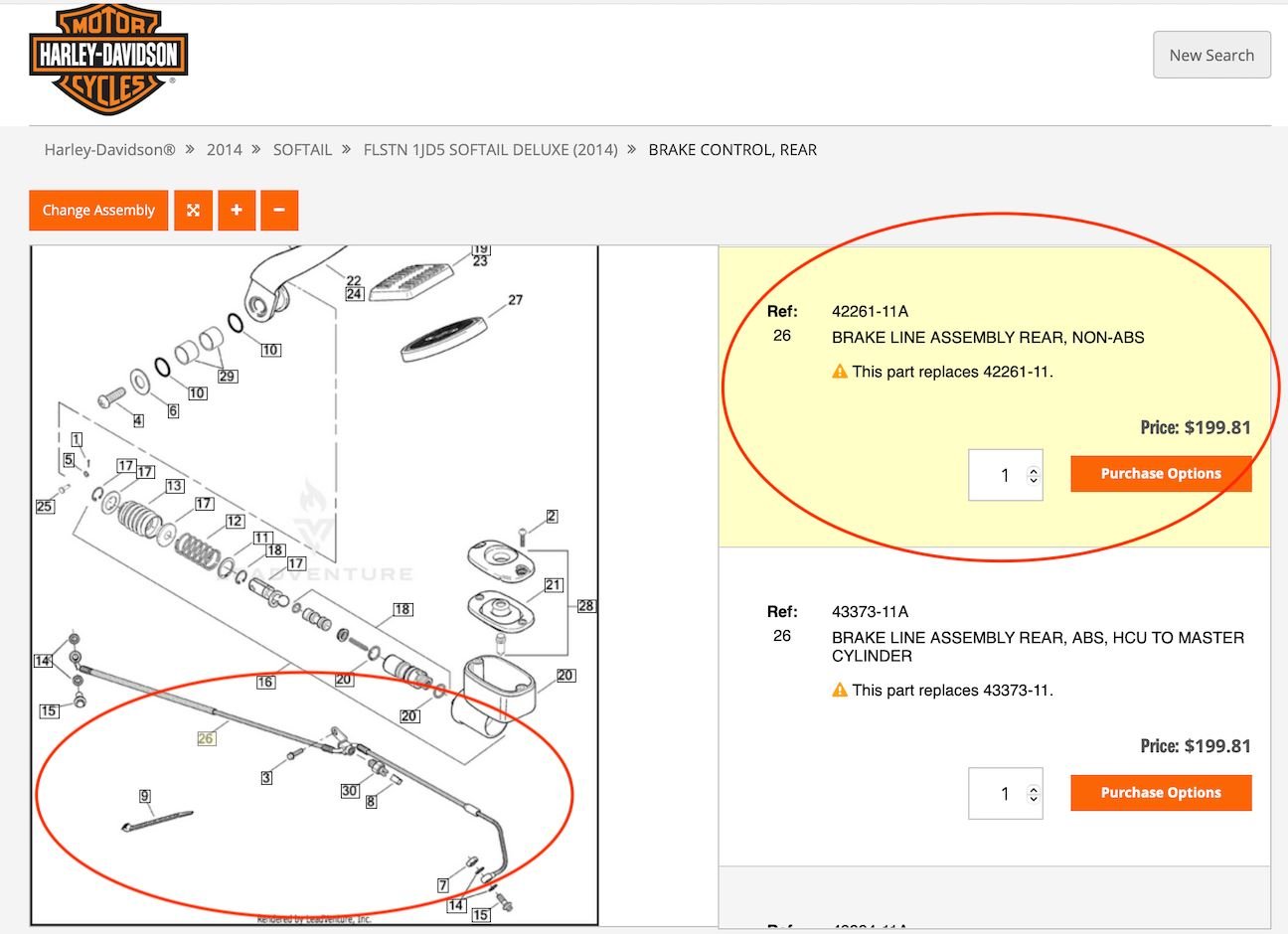

Yeah, you can bypass the ABS. The easy way would be to buy a 2014 Deluxe rear brake line for a non-ABS bike. (see pic below) ABS was still an option in 2014 on softails. Then I think you would have an ABS light on the gauges all the time. I doubt a dealer would disable an ABS system, although their Digital Tech II is used to select ABS or not. An aftermarket diagnostic tool, like the TechnoResearch Centurion Pro, could also do it if you know someone with that tool..
