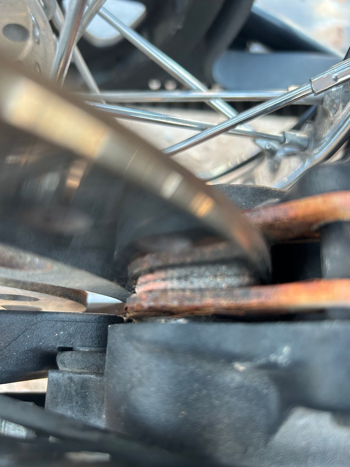

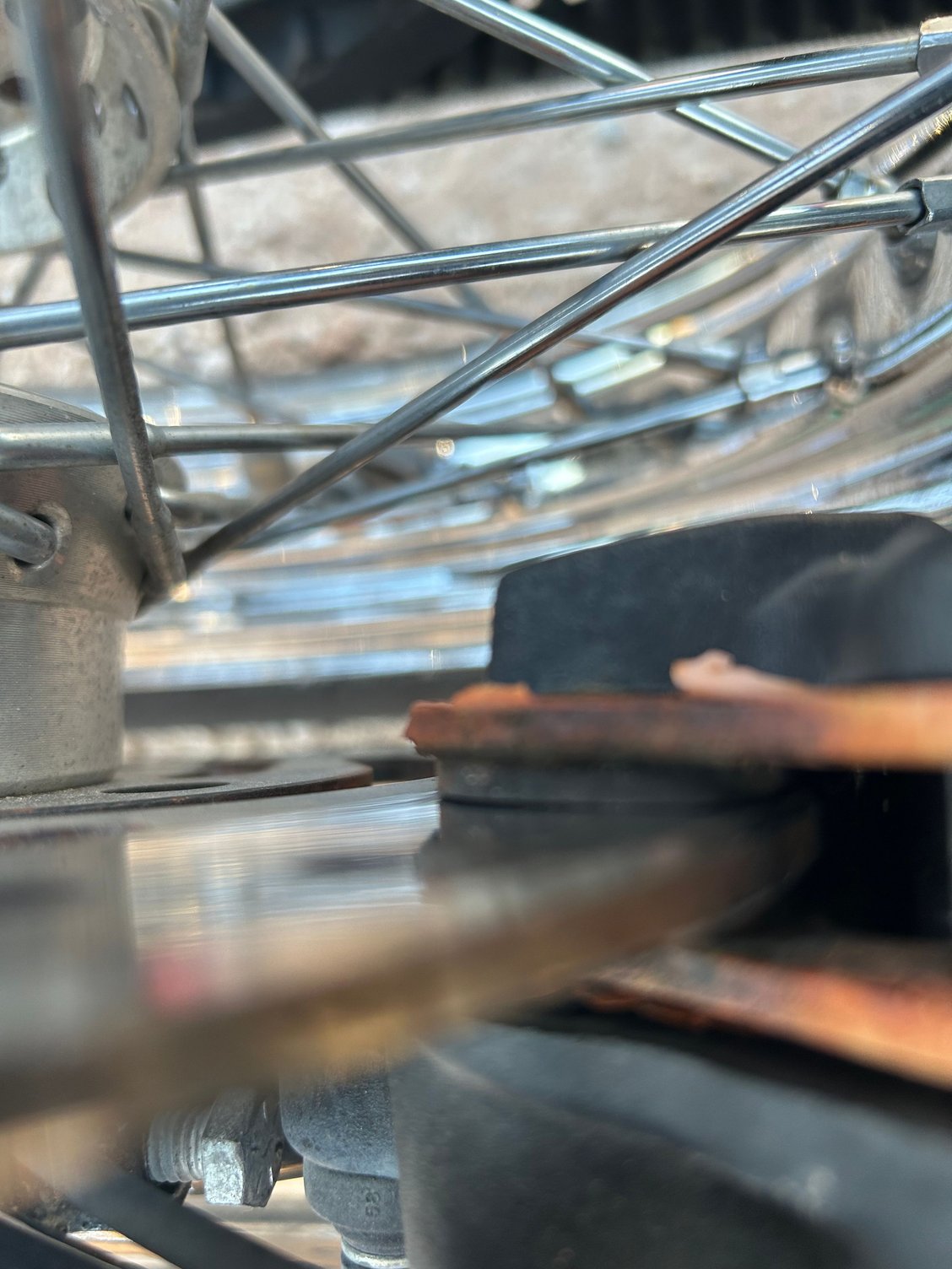

I’m outside removing the master cylinder and looked at the rear brake pads and they looked like they have gotten hot. Will someone please confirm my suspicions or am I just seeing things.

First thought would be an external leak even a small one.
With the pic above I'd want to take a hard look at the
Caliper and the piston and pads for any even dampness.
Even a very small amount of fluid loss can create this
Double ck all fittings and brake lines
Just to know how did you bleed the brakes ?
Scratching my head LOL
WP
I bought a Harbor Freight version of the mighty vac that you suggested. Just attached the hose to the bleeder and built up some vacuum before I cracked it open. A lot of air initially came out and then I got a few mini bubbles out.
I looked at the lines and caliper and nothing was wet. The master cylinder was also full. That bike needs some new tires and I think I will take it to Xtreme and also let them install some new pads. I’m not sure whether I should take the mc piston back to the Harley shop. My 06 Heritage uses the same part and who knows, I may need it someday.

The rear M cyl is a little lower than the caliper.
If the caliper has even a small leak that's where air could enter.
This would allow for the Mcyl to remain full. Seen before a few times.
