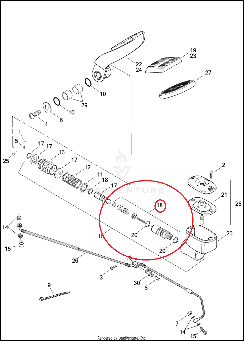

If you are positive the lines have been bled properly and before looking at the ABS or caliper pistons; I would look to a rebuild of the master cylinder as it had been sitting and the rubber components may have degraded not allowing pressure to be built up.
It looks like Harley upgraded the repair kit so there may be something that was causing an issue.
Ref:18
42382-87E
REPAIR KIT MASTER CYLINDER
This part replaces 42382-87C.
Price: $92.85

I bled the master cylinder some earlier and it’s starting to build up a little pressure so I’m hoping that the master cylinder needs to be rebuilt. Tuesday, I’m going to go by the Harley shop and see if they have a rebuild kit and if not I’ll order one. I’ll probably go ahead and get a set of pads while I’m at it. I have a tendency to believe that the mechanic that worked on it last year never checked the master cylinder or they were just trying to sell me an expensive abs unit.

Bout any Dot 4 fluid is good.
Cking with an Indy has done me good in the past as well.
The HD # 42382-878E looks to be correct according to Ronnie's but double ck it.
The Hd one looks to have the piston with the kit.
