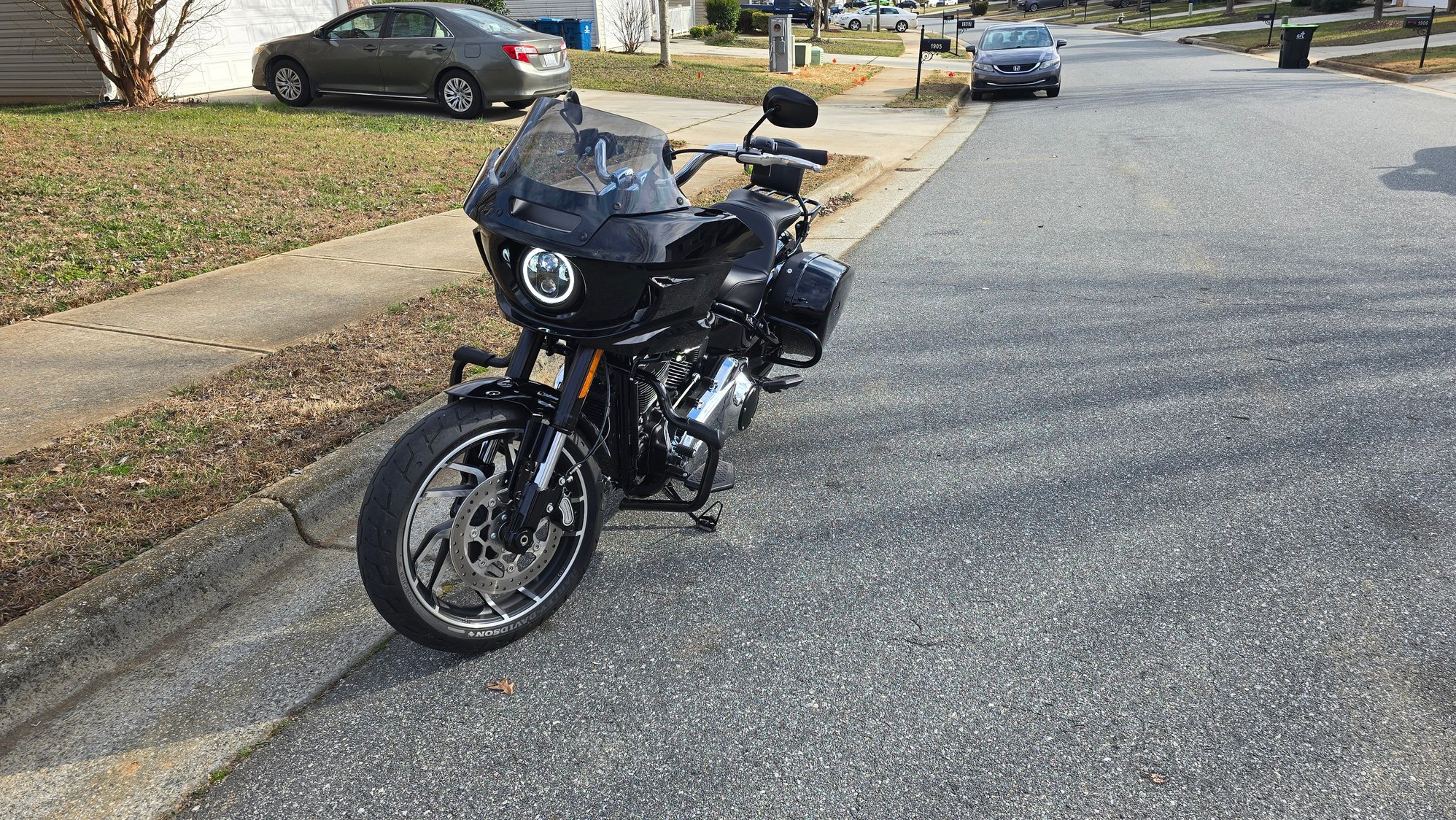

Hello,
I just ordered the ST fairing and their support bracket. I am trying to find out if anyone knows of any fairing supports that mount to my existing crash bar. Advanblack said they have not tested their crash bar mounts on a Sport Glide model, so they could not say it would work. I offered to be a test mule but was not met with an answer. I searched here, YouTube, multiple google searches and couldn't answer this question. I saw other sport glides with the ST but they all used the Advanblack support bracket that makes you remove the mustache style crash bar.

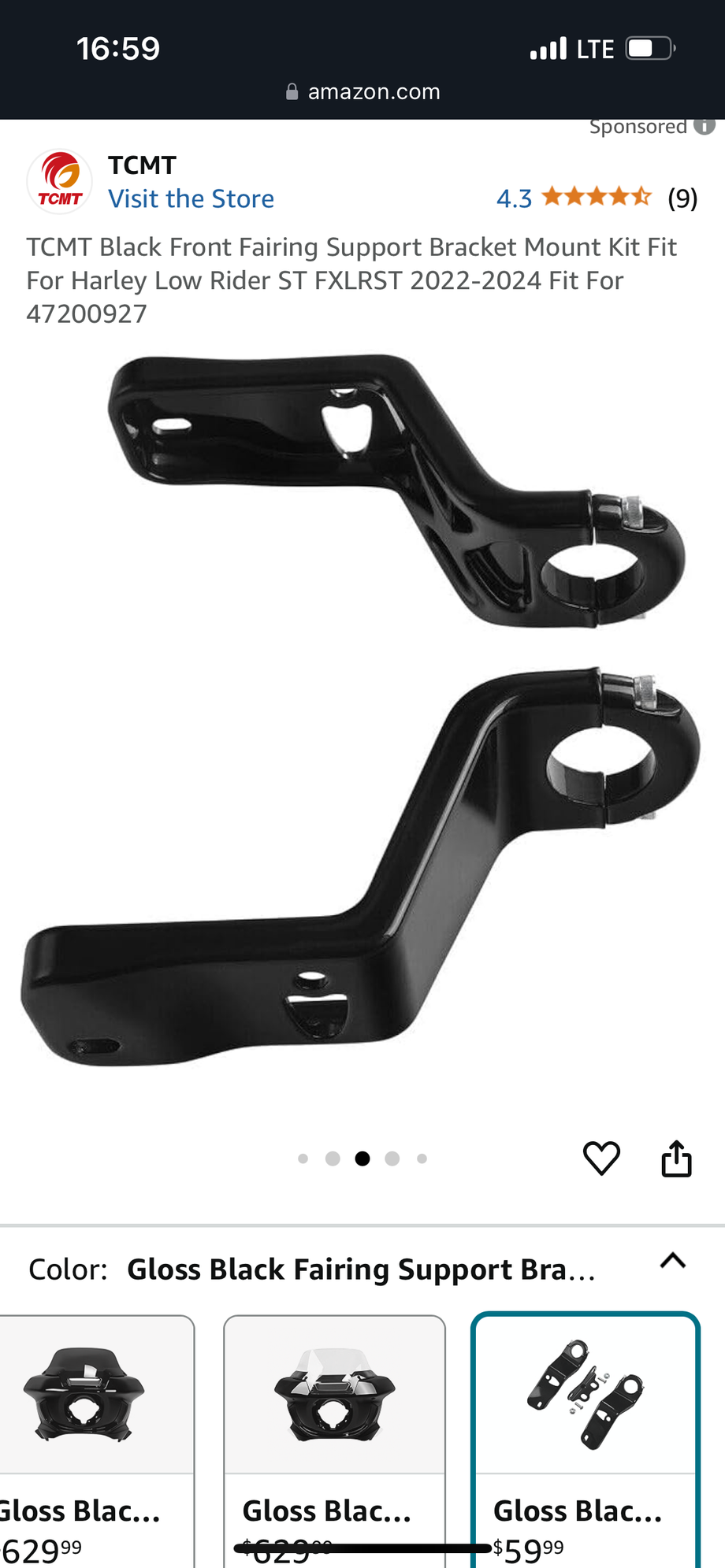

I used a Heritage fairing mount on a 2018 softail slim. These are the fairing support brackets I used to attach to the mustache bar.

I used those same TCMT brackets with the Advanblack ST fairing on my 2023 Softail Standard. They worked perfectly with the mustache engine guard.
Your Sport Glide will look great with the ST fairing set up.

I just wanted to say thank you guys for the information on those parts they worked perfectly.
