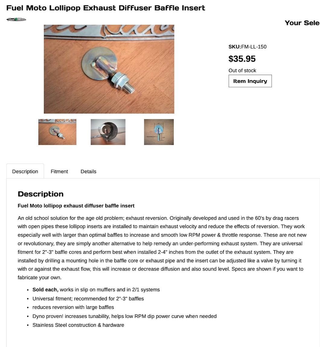

I am not an experienced tuner, many on this forum are... they will likely chime in...
Until then, AFAIK, your no-baffle fish tales are basically turning your exhaust in a "straight" pipe exhaust. Straight pipe exhausts are known to have "reversion". This reversion can negatively affect low-end power and throttle response. How much in a street application is hard to tell.
There are things called "Lollipops" (diffusers) that can be be put in the exhaust towards the end, that can minimize the affects of reversion, and allow for a better tune on straight pipe exhausts.
Your tuner should be aware of them, their use, and their effects... I would mention them to him and get his opinion on them...
Here is just one version of what is available, and what they look like.
Good luck with your mod...

Thank you hattitude for the detailed response. I also brought up Thunder, monster baffles which I think is really close to the lollipop.

i put monster baffles into my chikla pipes because of the snorkeling sound the pipes made even with a tune. Definitely fixed that issue and rounded out the tone a bit.
