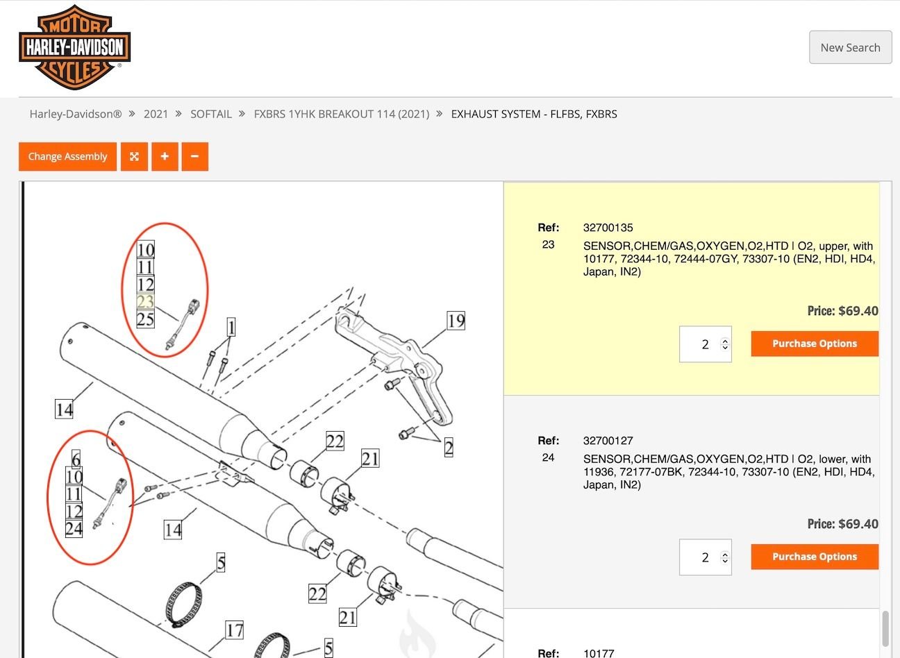

I have never worked on, or owned a bike with the four O2 sensor set-up. I would be leery of just pulling it from the exhaust, and not somehow dealing with it in the tune. I would be afraid it would affect the AFR... But I have no direct experience with that.
If you want to remove the muffler O2 sensors, they appear to have rather short pigtails. I would just disconnect them from the harness, at their connectors. It would be one less thing in the way to worry about. You could plug the harness connectors, or just put a blob of dielectric grease in them, to preserve the contacts for possible future use.
They are shown in the HD parts pic below..
#23 Upper muffler O2 sensor #32700135
#24 Lower muffler O2 sensor #32700127
