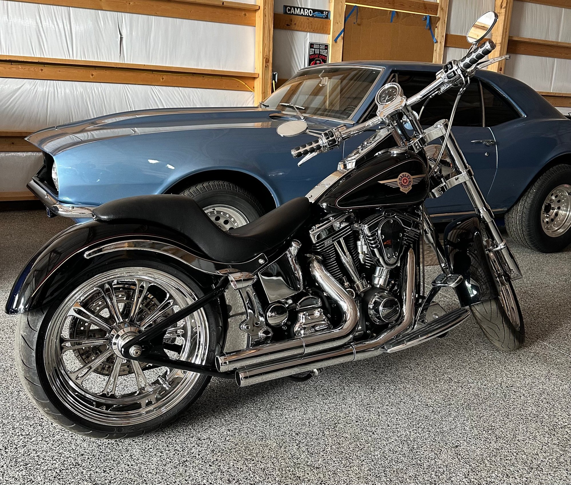

My '98 Fat Boy has a Performance Machine Phattail Kit installed. The builder of this bike installed only small bullet turn signals and a brake light in a vertically mounted license plate frame. I don't know how anyone would notice the brake light like this. As much as it'll ruin the clean look of the wide-*** rear fender, I'd rather not ruin my spine be being run into since I ride in traffic.
Do any of you have ideas around options that would work for that surface? Of course, as minimal as possible, but I've got to have something visible.

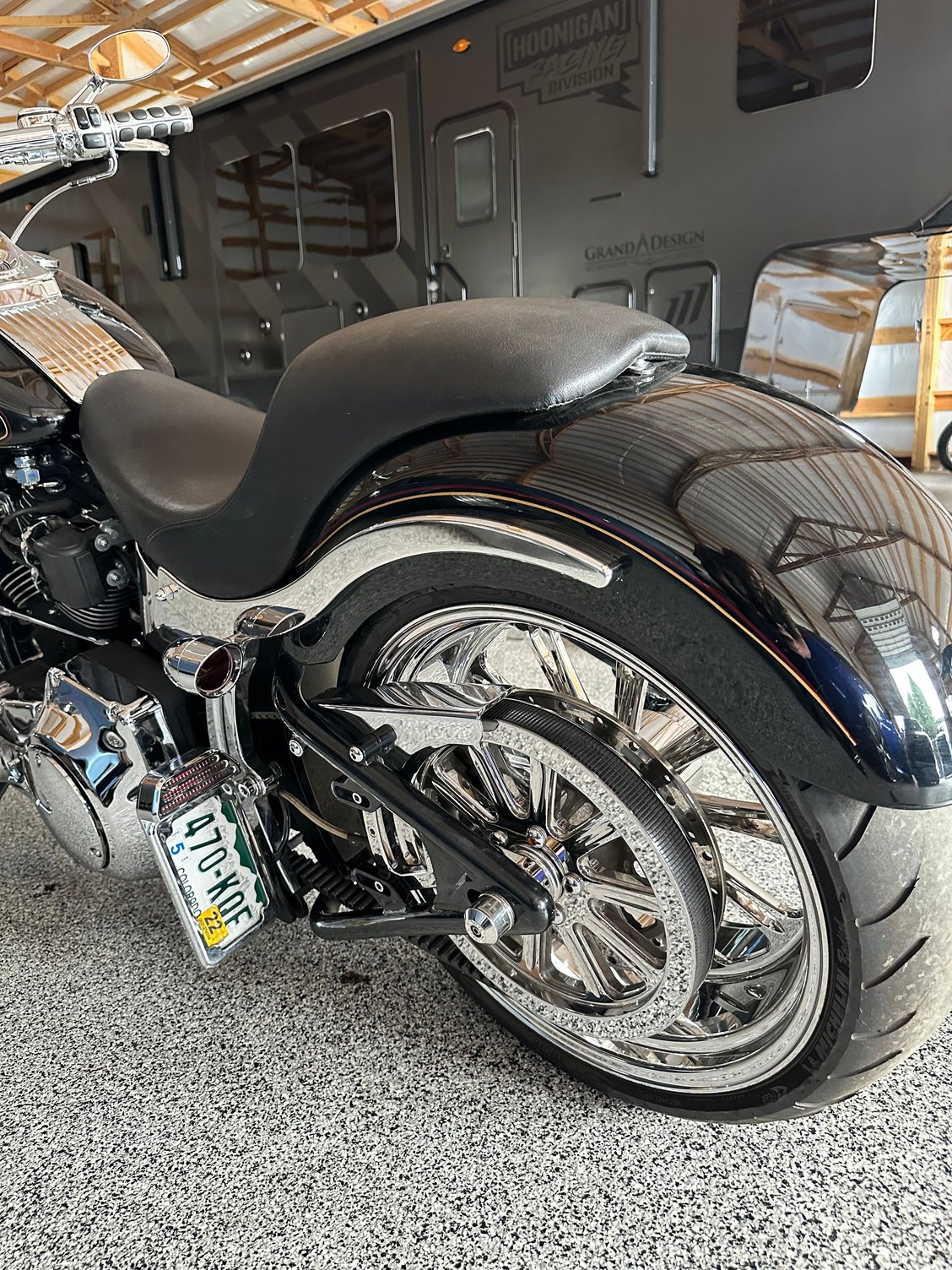

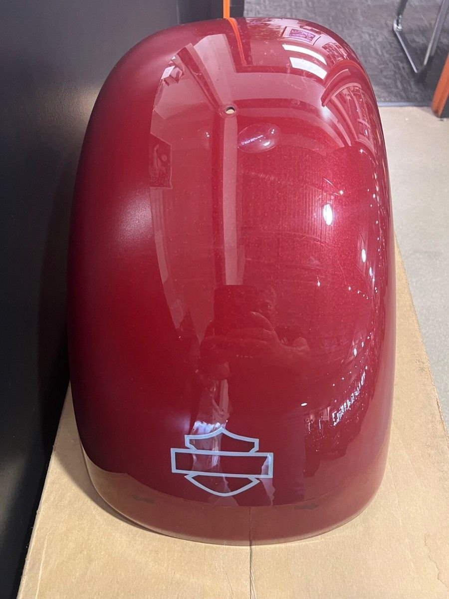

Yeah, sorry about the angle. I know it’s tough to tell how flat/curved it is from the side photos. I just don’t have access to the bike as I’m traveling again but this is a better angle and found the red one online. I am planning on needing to have a custom solution.
