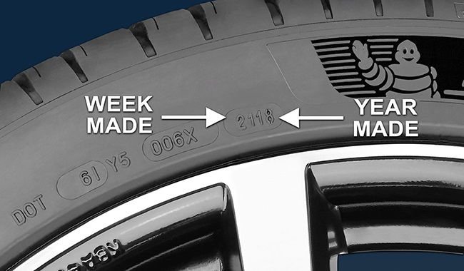

Look at the DOT date code on the sidewall of the tire. That will tell you the tires age. It is a 4 digit number. The first two digits is the week and the second two digits is the year it was manufactured.
In this example, the tire was manufactured the 21st week of 2018.
In your case, the new tires were put on the bike and then the bike sat for 2 years but how long were the tires sitting on the shelf before being put on the bike? Report back with the DOT date code on the tires.
