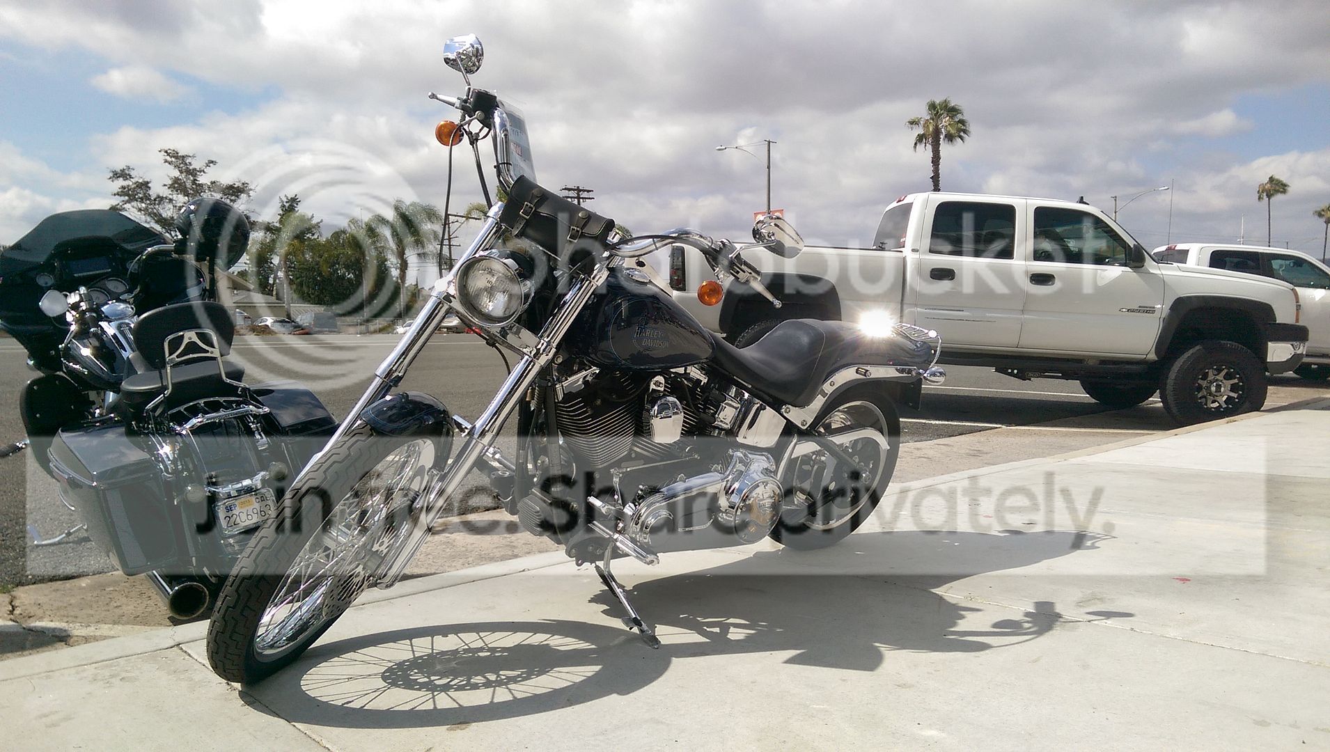

I've got a 2009 FXSTC with what I believe to be the inverted fork kit linked here. According to the HD website, the forks are 52mm. Is that the upper forks in the triple tree? Here are some pictures if that helps:
