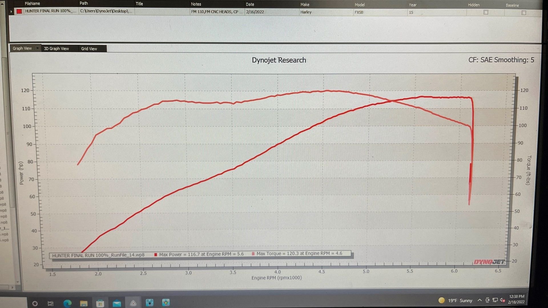

2015 Breakout
Fuel Moto 110" 10.5 compression
Fuel Moto level B heads
HPI 55mm Throttle body with 5.5g injectors
S&S 585 cams with S&S oil pump\plate
Triple stepped exhaust with DK Customs inserts
PowerVision tuner

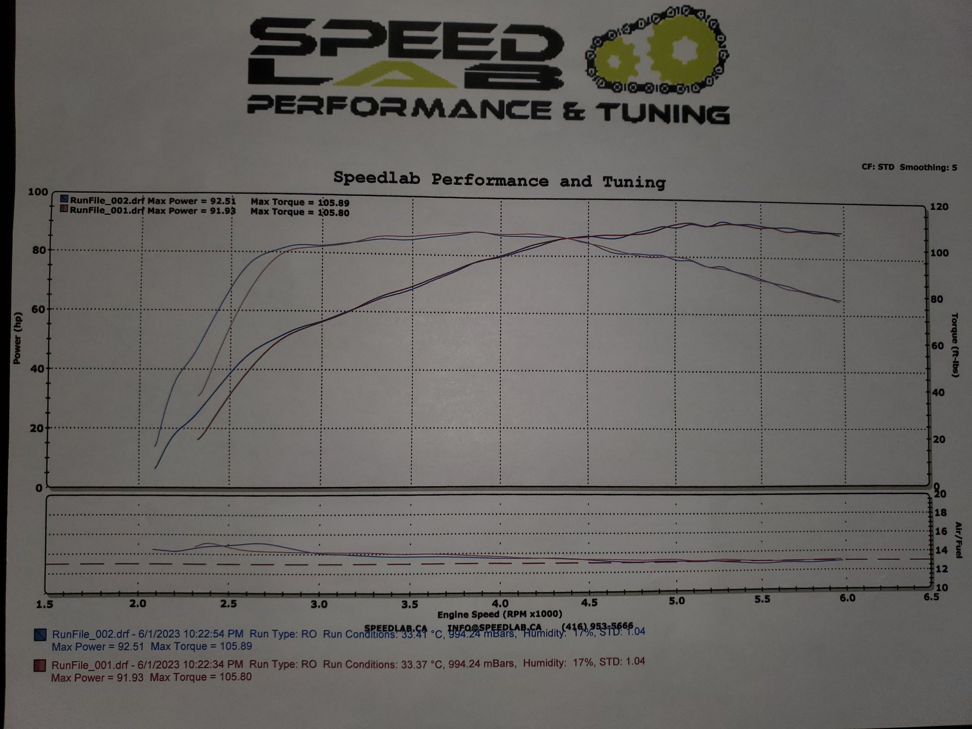

'02 FLSTF
My goal was a reliable build with decent performance:
0922-0118 S&S Stroker Crank
0924-0108 S&S Timken Bearing Kit
HD Left Side Crank Bearing
0931-0430 S&S 106" Cyl/Piston Kit
0926-2056 S&S 650 Spring Kit
0925-1048 S&S 635 HO Easy Start Cams
0932-0110 S&S Cam Plate & Oil Pump
0929-0005 S&S Lifters
0928-0023 S&S Quickie Pushrod Cover Kit
2101-0219 Daytona Twin Tec Ignition
S&S Super Stock 79cc Performance Heads being reused
S&S Super E carb

92.51 Horsepower
105.89 Torque
