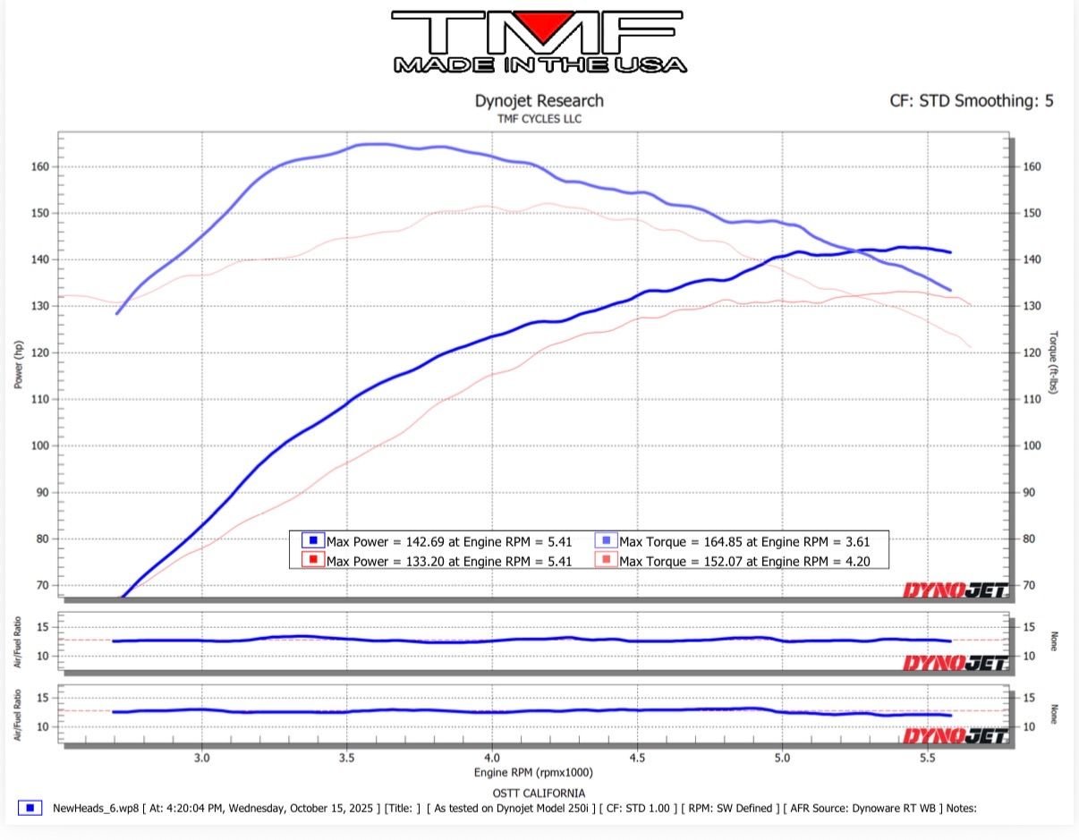

Originally Posted by Jeremiah77
Thanks! We are expecting 160 HP with new heads/cam... maybe 170 TQ too hopefully. New parts are more geared toward HP though
The M8 “might” finally be that technology has passed the threshold. So far Shovel, EVO, Twinkie all can make reasonably good power up to say 1.1hp… maybe 1.25 per cubic inch. Once over that threshold reliability flys out the window. If you really see 160/170 outta a 128” and it stays together 35,000 miles and can do say 500 mile round trips then I’m really impressed. I’d actually do it. I’m hoping it will.
I have known of a few M8’s that made 170rwhp and seemed to have decent street manners but of the ones I personally know about, they didn’t last long at all. I’m not a Debbie downer on M8’s at all. I’m Rooting for it to be the design that pushes relative reliability past the 1.3 hp per cube.
When I make comments like this folk seem to think I’m blasting M8’s… No, I’m taking 30 years of making Harleys fast experience and sharing devils advocate to hear the responses. Ya’ll are spending thee big bucks and I’d like to learn what’s to do but more importantly what not to do.
I watched one fellow that legitimately made the 170 number spend about $20k to do it…. And it “did” it for about 6,000 miles before total loss and having to start over.
So your experience is encouraging.. especially if your soup recipe stays reliable… It means it would be time for me to hang up the big EVO’s and transition over.. I’m still gonna go carb though lol. Ain’t teaching me FI new tricks.

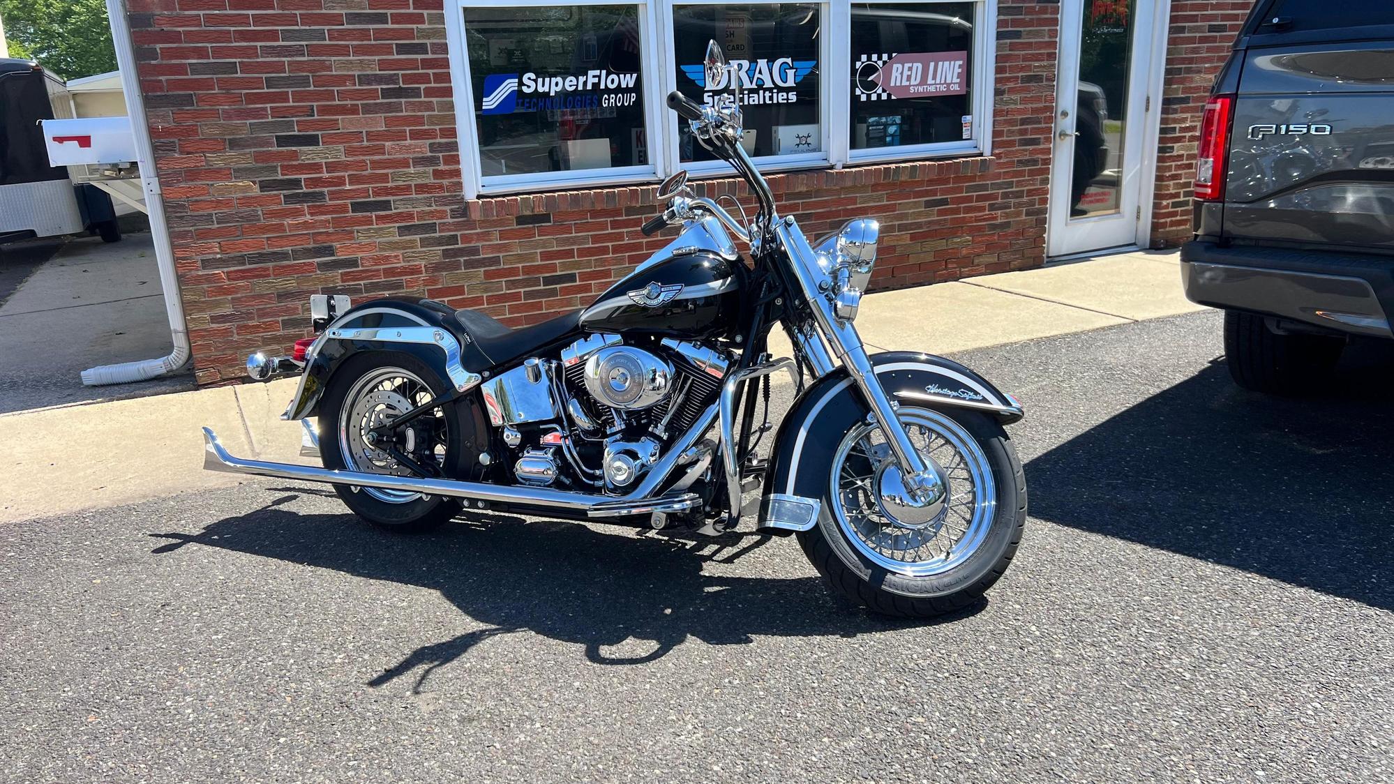

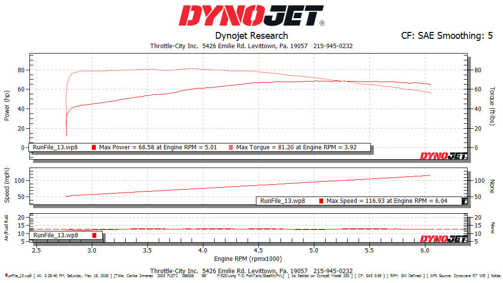

Default 2003 Heritage Softail with Fueling 525 Upgrade
Just got my twin cam 88 dyno tuned after I installed the Fueling 525 cam chest kit. Wasn't looking for high numbers, just reliability and to replace the stock cam chain tensioners. The Bassani full fishtail exhaust doesn't really help any with performance, but Im going for a full vicla build (not going for max performance from this build). The exhaust also contains no baffles and sounds rowdy as hell (which so far I'm really liking). Now that 'm done tinkering with the motor it's time to move on to cosmetics (handlebars, wheel, paint, air ride etc.)
