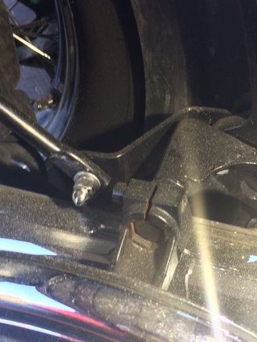

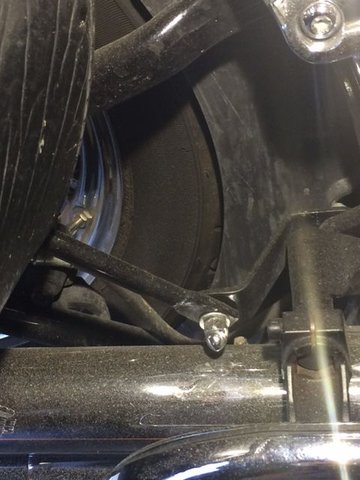

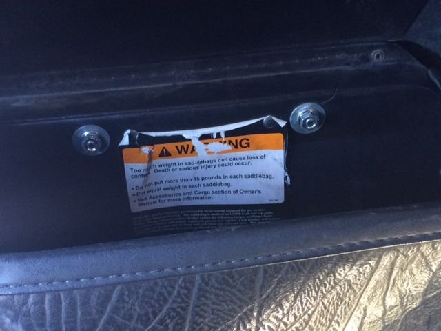

What are you looking for specifically?
There should be two mounting bolts on the side of the fender that feed through the top of the bags, then nuts put on.
Then there should be a bracket that mounts to the frame.
Hopefully these pics will help.
