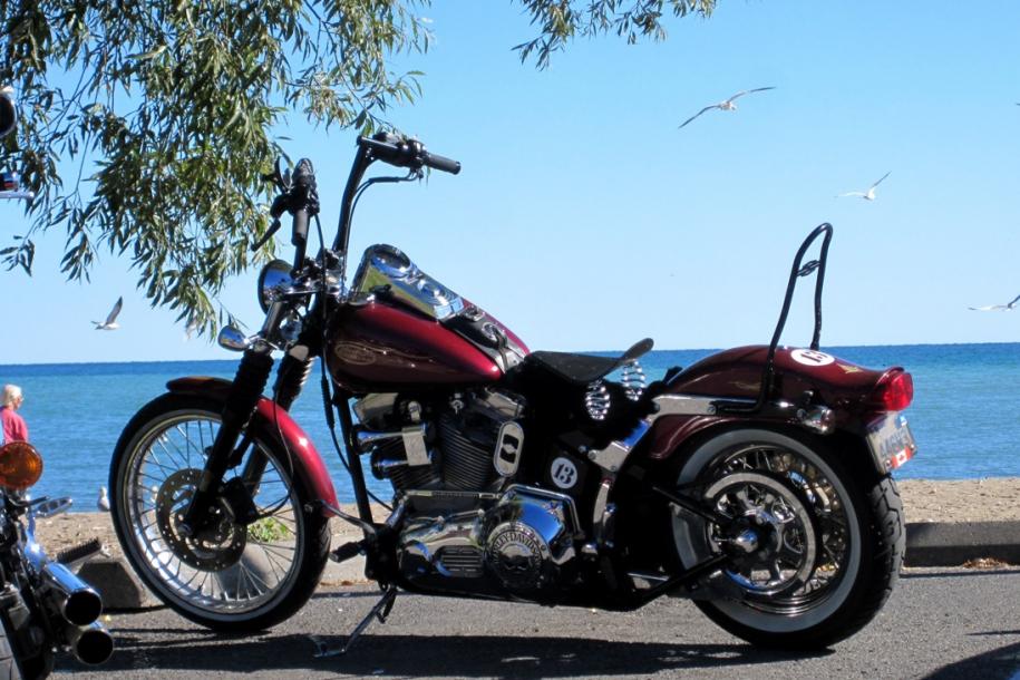

I also got aftermarket pushings .. poly... something rock solid ..
