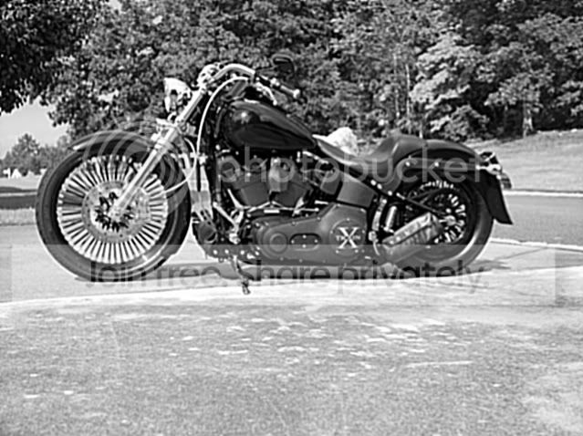

I had started a good thread about this very subject.... Here Bro:https://www.hdforums.com/forum/softa...ison-pics.html
Needless to say the 2 under fork tubes are magic. No mas fork flex, bike handles like a GSXR....Pfffft. Joking but it really rails, holds a good line, looks better IMO and has better balance at speed. Combine the 2 under tubes with a progressive lowering kit and your handling will be golden!
Another guy PM'ed me the other night. He is gonna do a set of 4 unders....My ******** isnt big enuff to try the -4's but if his is sweet? I may change up to the 4's with stock guts as well.
