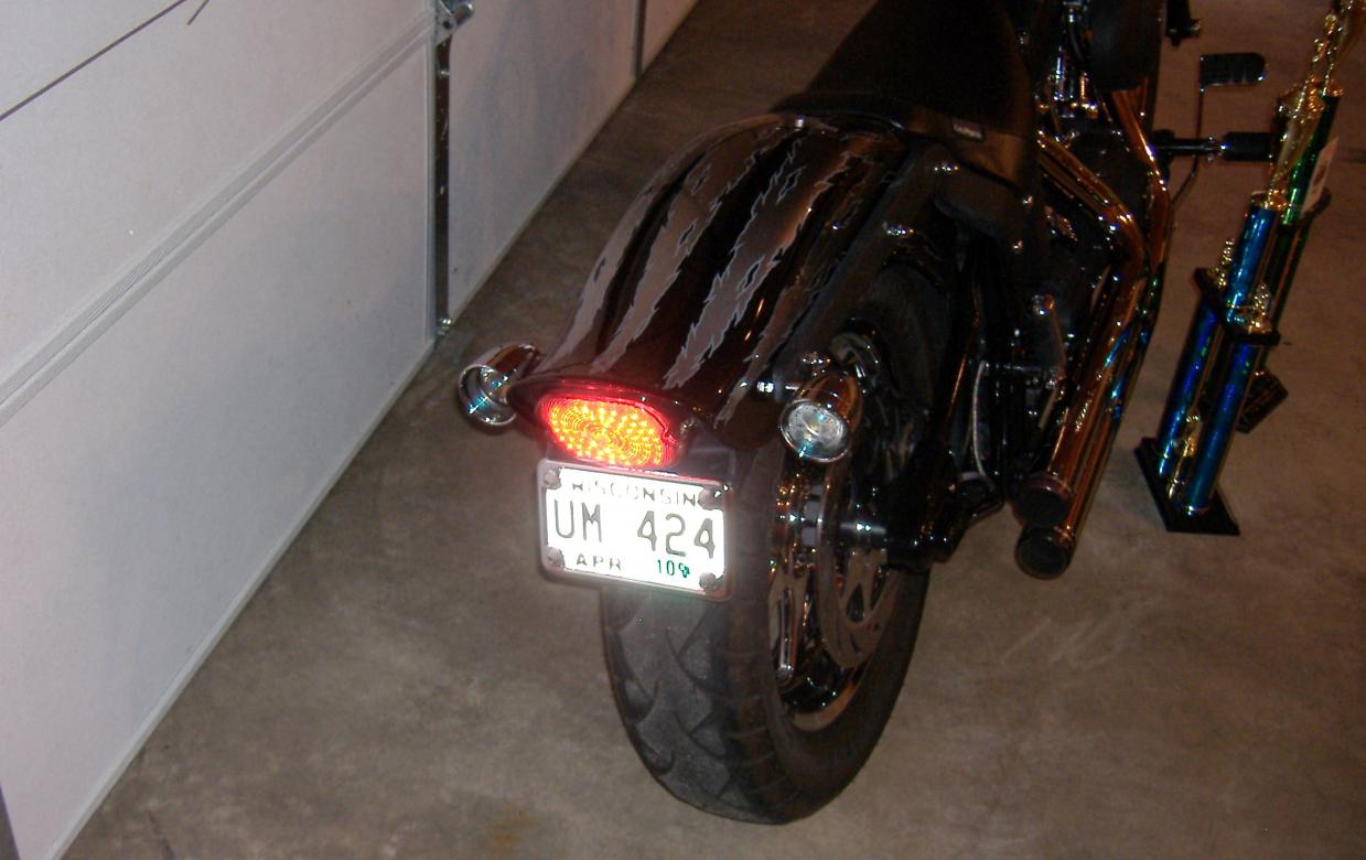

I put a Kuryakyn lo-pro smoked LED tail light in my 2001 FXSTB-I. Its a plug and play. 15min job. They also make a tail light flash module but I dont have it. I run Silverstar blinker bulbs, not as bright as LED's but I dont have to use load equalizers. Hope it gives you another option.

I think I am going to do excactly just that, I will get the Flasher/running day light combo + the LED Kuryakyn.. I do not want load equalizers as they heat up a lot and I ride my bike often and I insist on the running day light thing.
