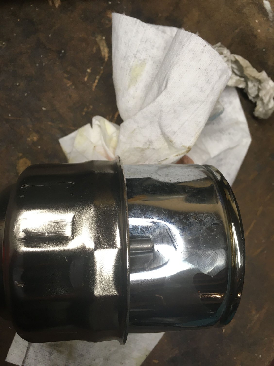

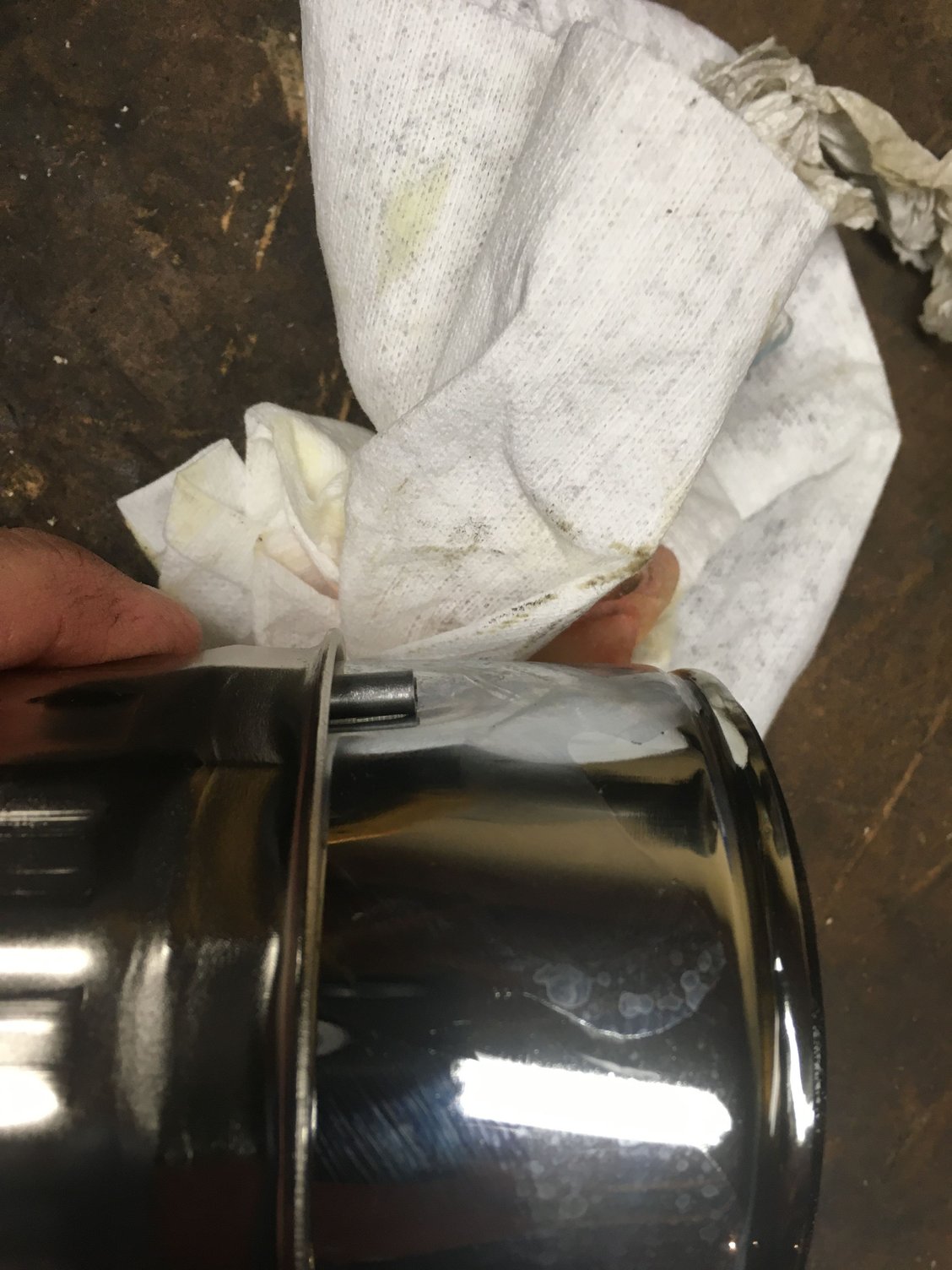

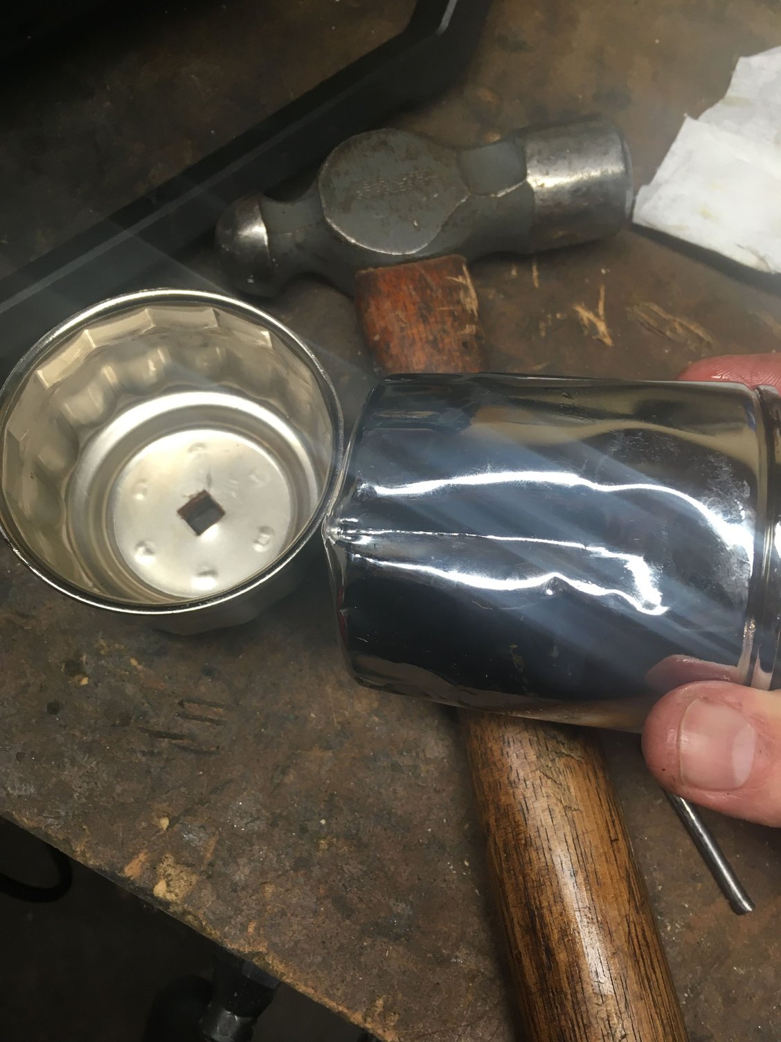

I took a small piece of steel brake line and hammered the cap type oil filter remover over the top of it and the oil filter. It smashed the steel line into the filter to give it some bite. It came right out. Then I just smacked the filter to get it out of the remover. It worked pretty slick.
