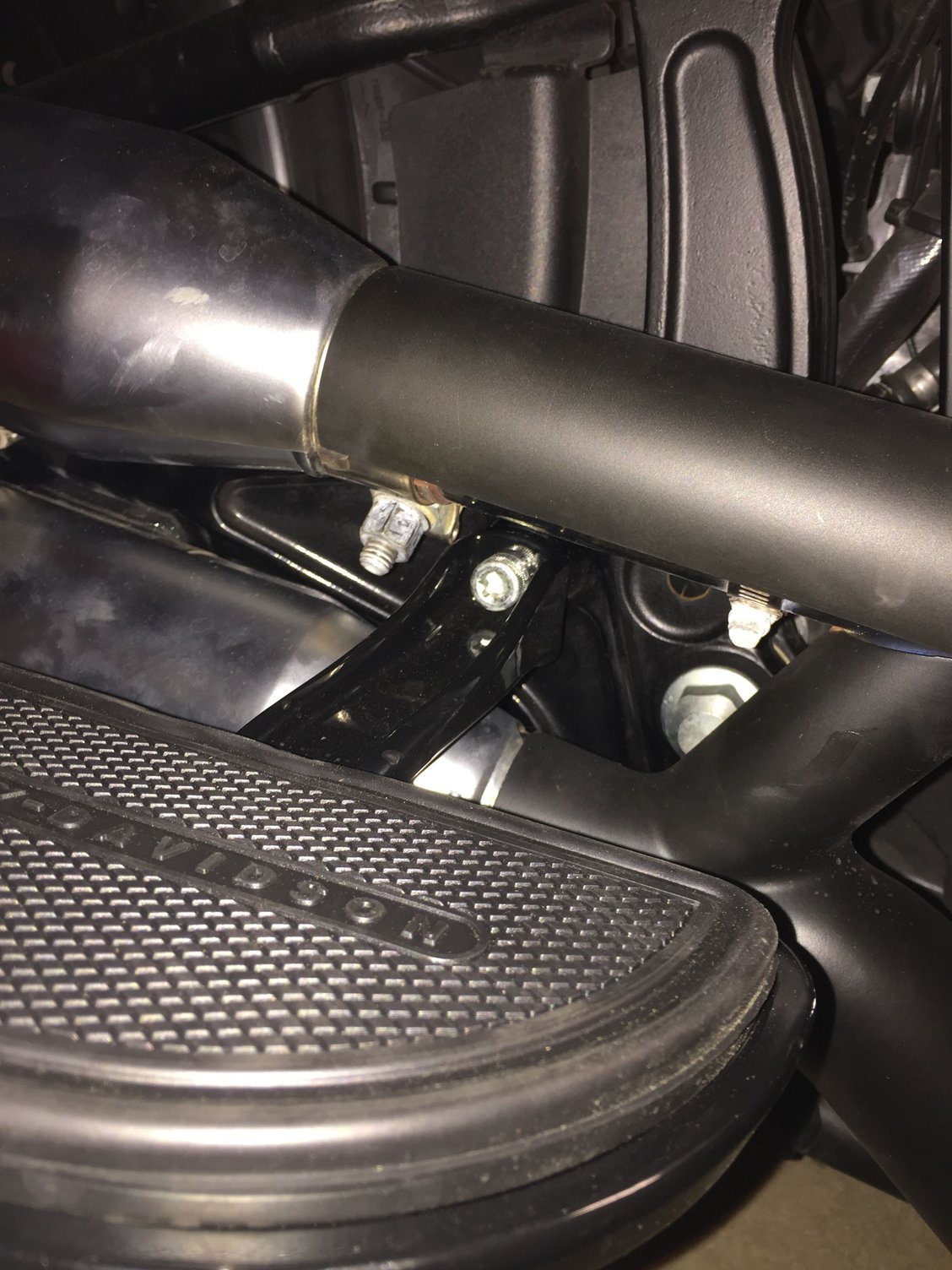

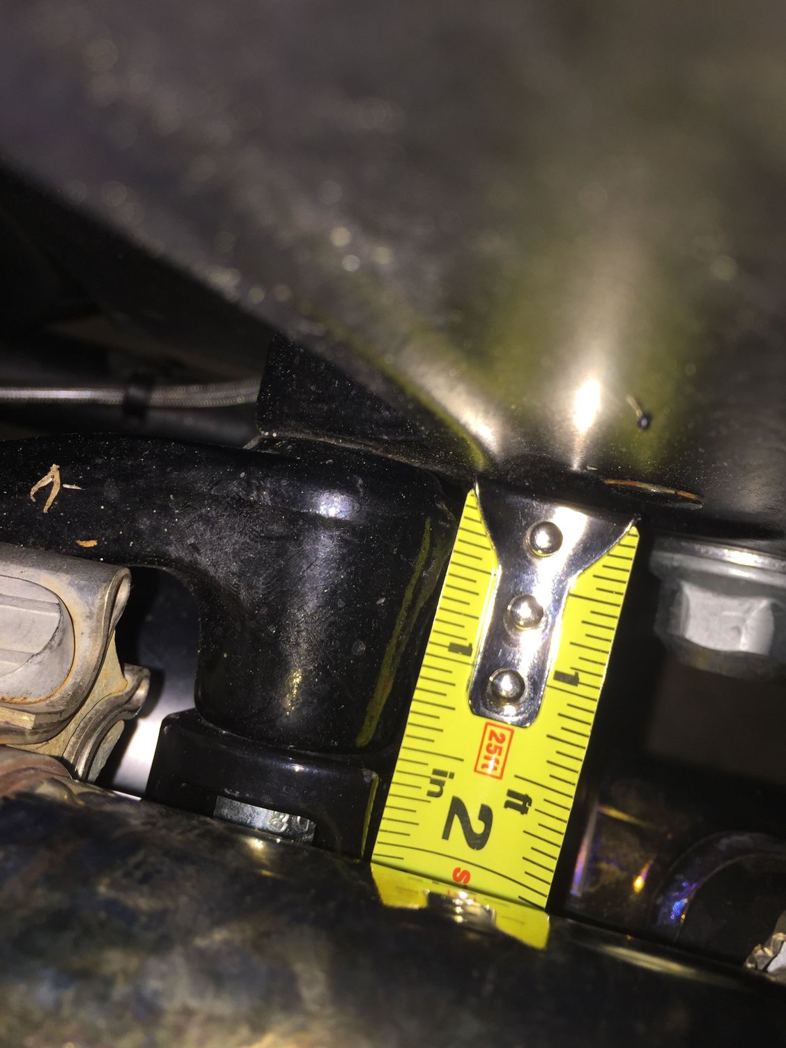

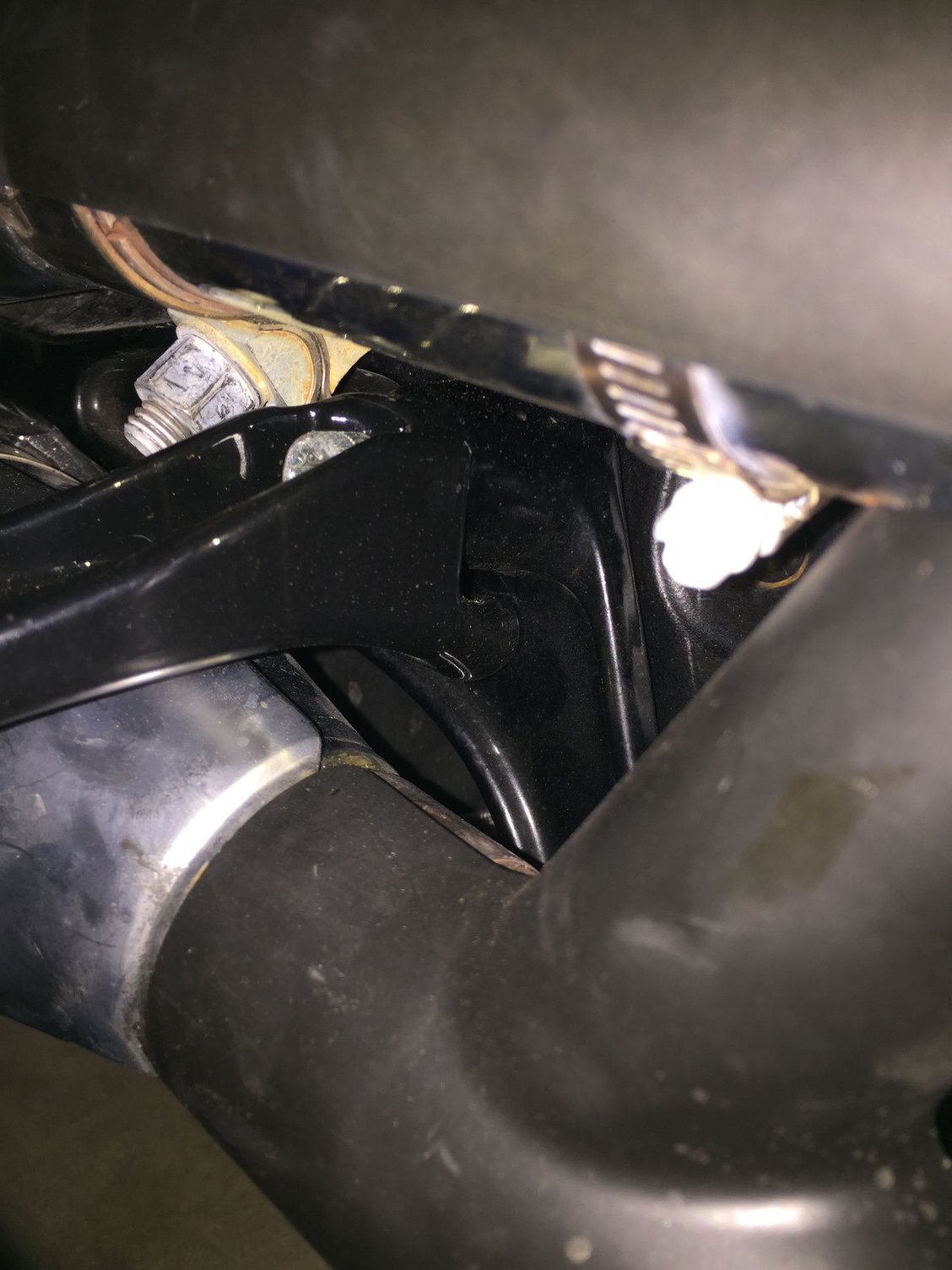

Another probably silly question. I'm looking to get the lady some passenger floorboards, preferably of the HD variety. The pipes that I have are aftermarket and the kit on HD.com (http://www.harley-davidson.com/store...-07-5039907--1) is showing that the right side has to connect to the muffler bracket which is no longer present. Anybody have any clues on what I should buy or advice on fitment?
So just cut your passenger peg mount that you currently have to 1-5/8" to be used as a spacer and walah. You could just use a shorter bolt and mount the floorboard without it too, but probably won't be symmetrical with the other side. Here's some pics
Originally Posted by rogers_trafton
Right side. Which is the main problem
The only thing I just thought of though is there is a pin that goes into a hole below the bolt location that keeps the whole floor board mount from being able to spin, which is also only on that exhaust bracket.

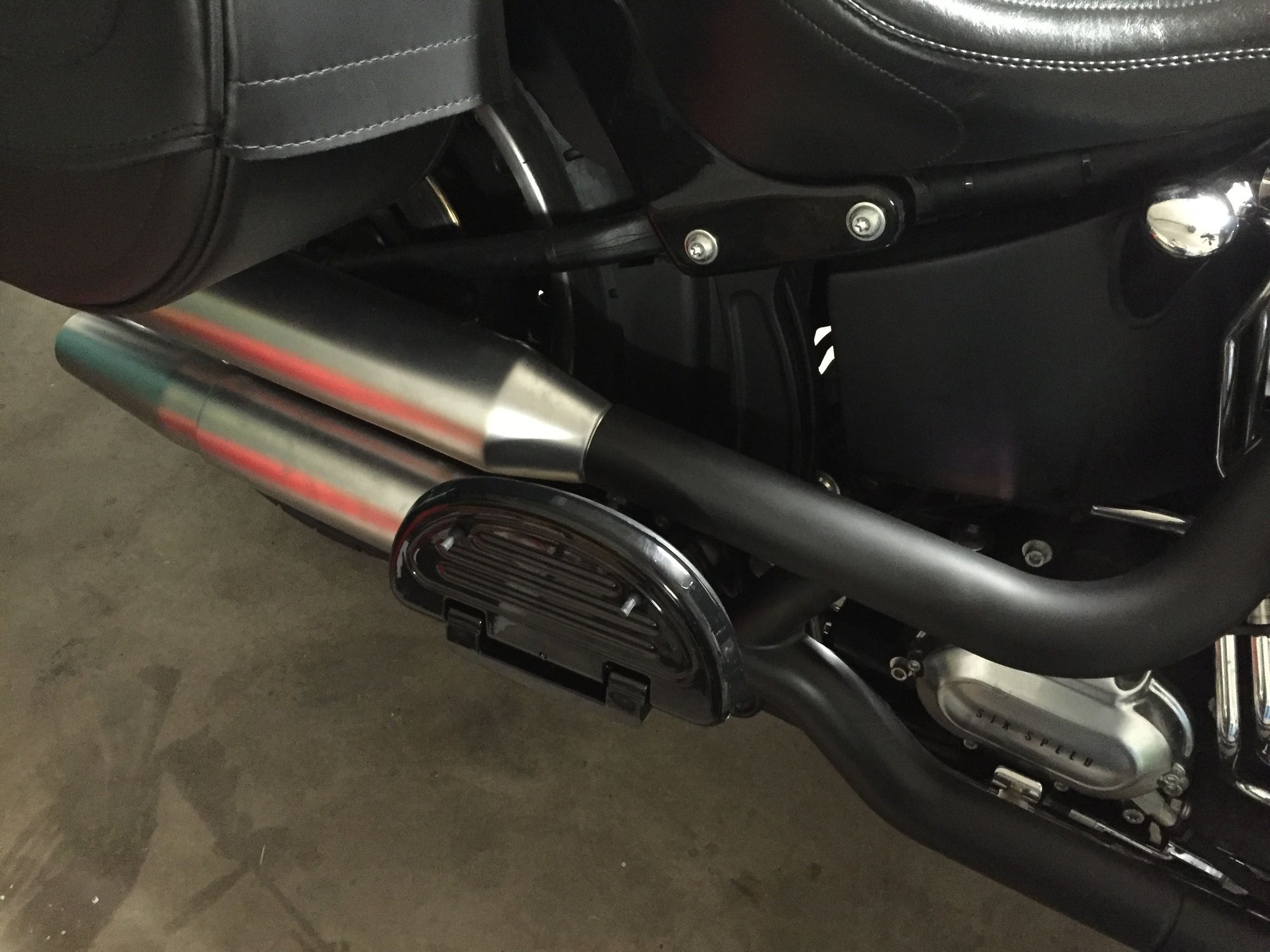

Here is what she looks like
That's where I'm running into issues trying to get something going figured out. Thought maybe about using the kit that has bothe brackets identical to the left side.

Originally Posted by Freak Show
i'd go with the smaller boards and above the pipes, less chance of burning the inside of her leg
The pipes that I have won't allow for the inbetween like the stock pipes will. I would have to go above no matter what, issue is that the mounting position is almost dead nuts on the line of the pipes. Might have to fabricate something to make them work, especially considering HD is overpricing the **** out of those mounting kits.
