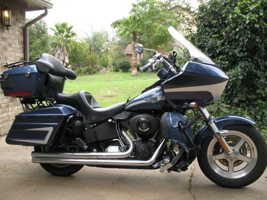

Originally Posted by dub976
What kind of tour pack is that? is it detachable? my wife would love to have a armrest like that. bike looks good.
Yes, it is detachable.
http://www.harley-davidson.com/gma/gma_product.jsp?PRODUCT%3C%3Eprd_id=84552444198868 3&FOLDER%3C%3Efolder_id=2534374302288803&ASSORTMEN T%3C%3East_id=2534374302288803&bmUID=1303149444854 &bmLocale=en_US
It comes in two versions. ’00-’05 and ’06-later softail.. depending on rear tire/fender size.
I have an ’03, which would normally take the narrower 00-05 bracket. But the bracket is designed to set flush up against the fender, and I have two 1/8” brackets on each side of the fender that fit inboard of the Detachable Two-Up Tour-Pak Mounting Rack. This means a full 1/2 inch wider than the narrow bracket. So I got the bracket for the 06 and later bikes, about 2” wider, and had a 1 1/8 inch section cut out and welder together. Then I had the mount powder coated black.
Attached Thumbnails "New" Road Train...my winter project is over.-img_1811_small.jpg   "New" Road Train...my winter project is over.-img_2043_small.jpg

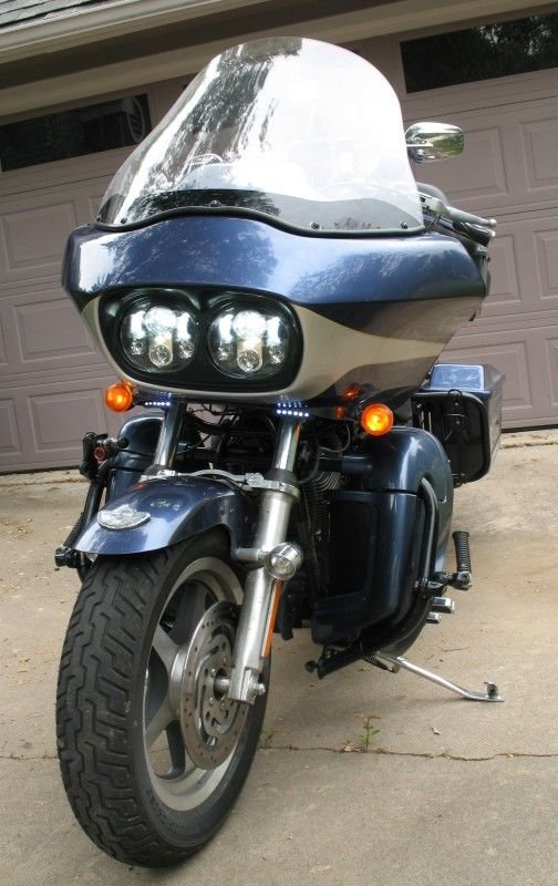

Newer pics with lowers and LED headlights.
Some have asked about converting front wheel from 21". Here is a previous post I made:
https://www.hdforums.com/forum/frame...n-softail.html
