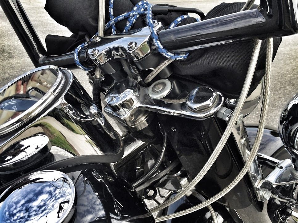

This is an old thread but, it's answer my question....Good-n-tight!!! is the answer!!
