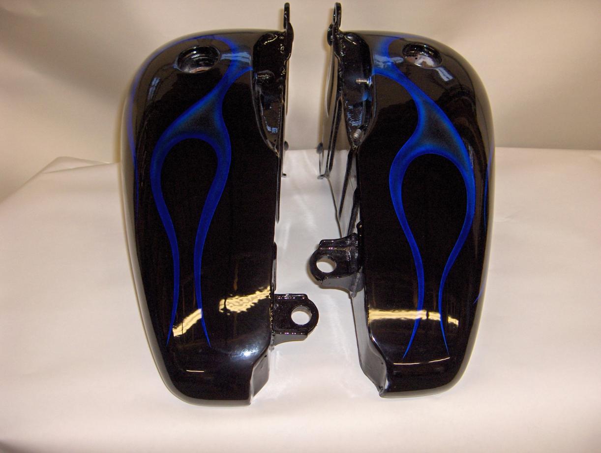

I am buying a new frame for a custom build and the frame manufacturer says that it accepts softail stock tanks. I already have a set of flat side tanks from a softail and the frame mounts look totally different. My question is is there a piece that I am missing or what type of tanks do these frame mounts accept on this frame?

And here are the tanks

Ask the builder what year(s) tanks fit on this frame. Yours look like older Evo tanks? Maybe it fits the tanks from the newer bikes?

It should come with another piece. That deal sticking up in the middle mounts the tanks & consol.

To mount those tanks on that frame you need a "Flatside tank mounting kit"

I understand what you are saying as this is not really a custom forum and that is what I like about it for my stock bikes. But as far as that frame it is a stock replacement frame for oem components.....so it would use direct replacement parts and mounts. And you guys came through and answered it so Thanks
