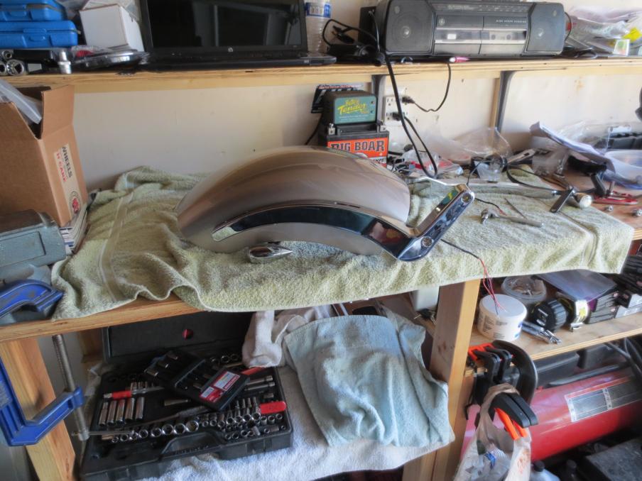

Not thrilled with the front of it after cutting so may do some more...

I think you gotta cut the back of the fender as well. Maybe to a longer point than the front.

Yea I had to stop cutting on it bro. I made several adjustments and it was getting scary. When I was doing it it felt like I was making a $320 mistake. But after the paint it came together for me. I'm alright with it now. The long fenders just don't do it for me and there wasn't anything out there (I could find) that was shorter so it had to be chopped. lol
