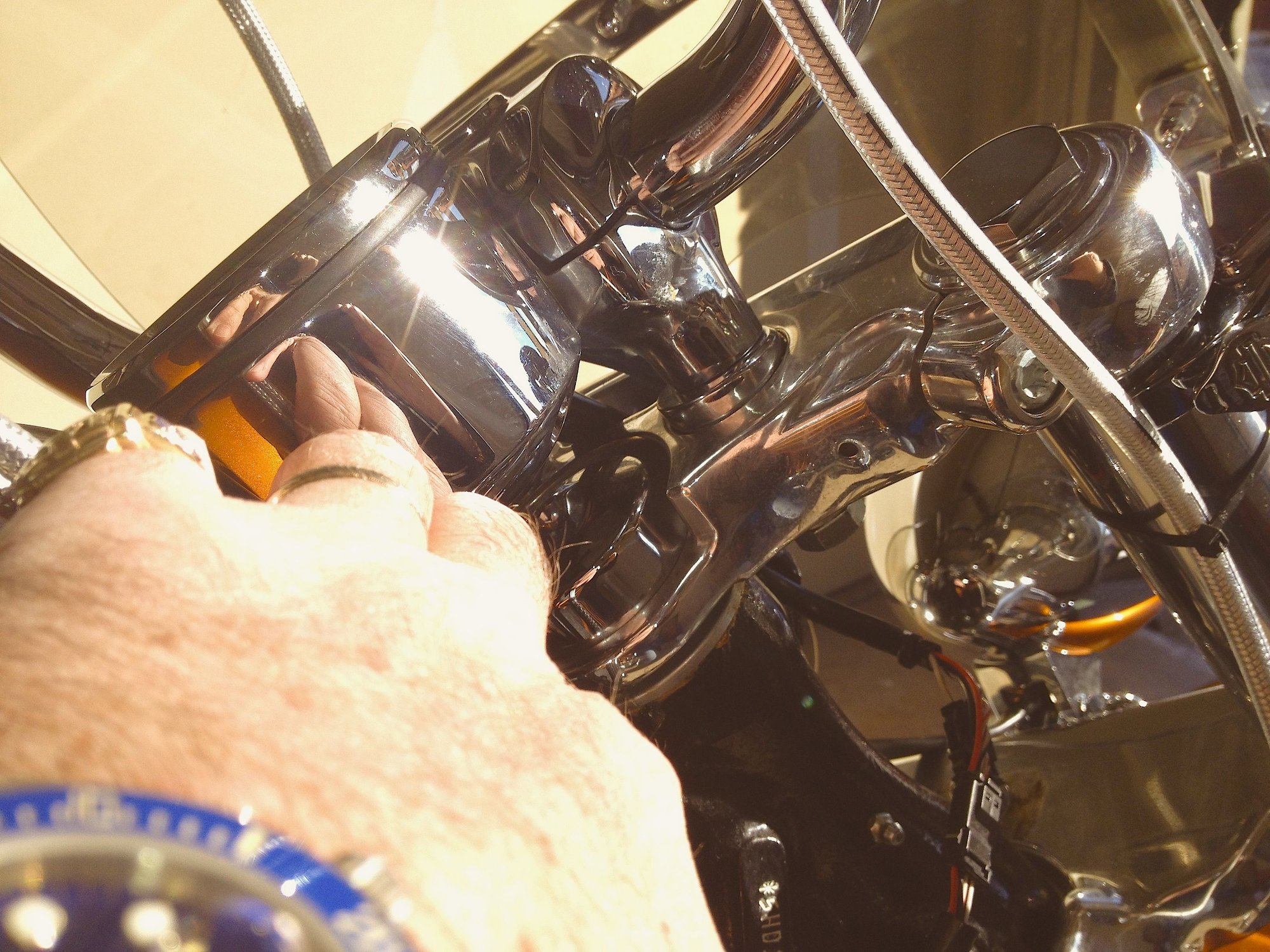

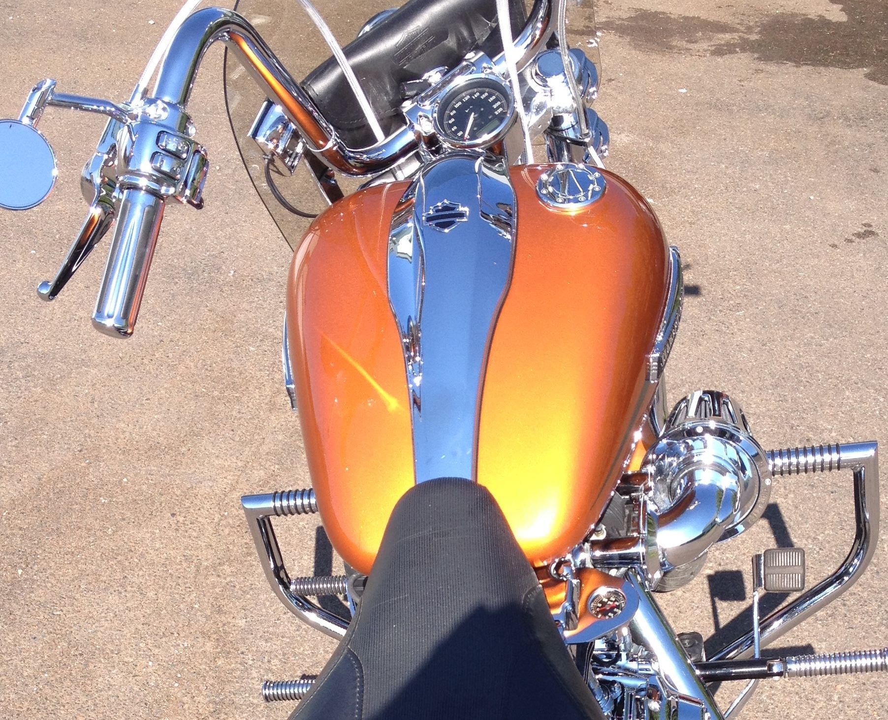

Originally Posted by Lindosan
So..... will I be able to install the black liner tank console and tank lift with my cvo riser ? If yes how many inches can I lift the tank ?
Was thinking about the Dead Creak kit....
I'm also thinking about the cvo tank console if it's better with the tank lift ?
Cheers
You can lift your tank but you need to install the 10 degree riser bushings, which are available from Dennis Kirk, so as to move your speedo slightly forward. Lift your tank as high as you like.
https://www.denniskirk.com/la-choppe...prd/598833.sku
The only issue may be handle bar clearance. Its advisable to do a trial lift before proceeding and you will need to extend the X-over tube. Check out DK custom (sponsor) site. They sell a great well made kit including the X-over.
My lift is 3", the view of the speedo is better than pictured above when you're in the seat. Doing the lift as you plan also has the benefit of using the speedo / housing to conceal the post lift gap at the front of the tank which keeps some guys from doing a lift on other models.
Hope this helps.
