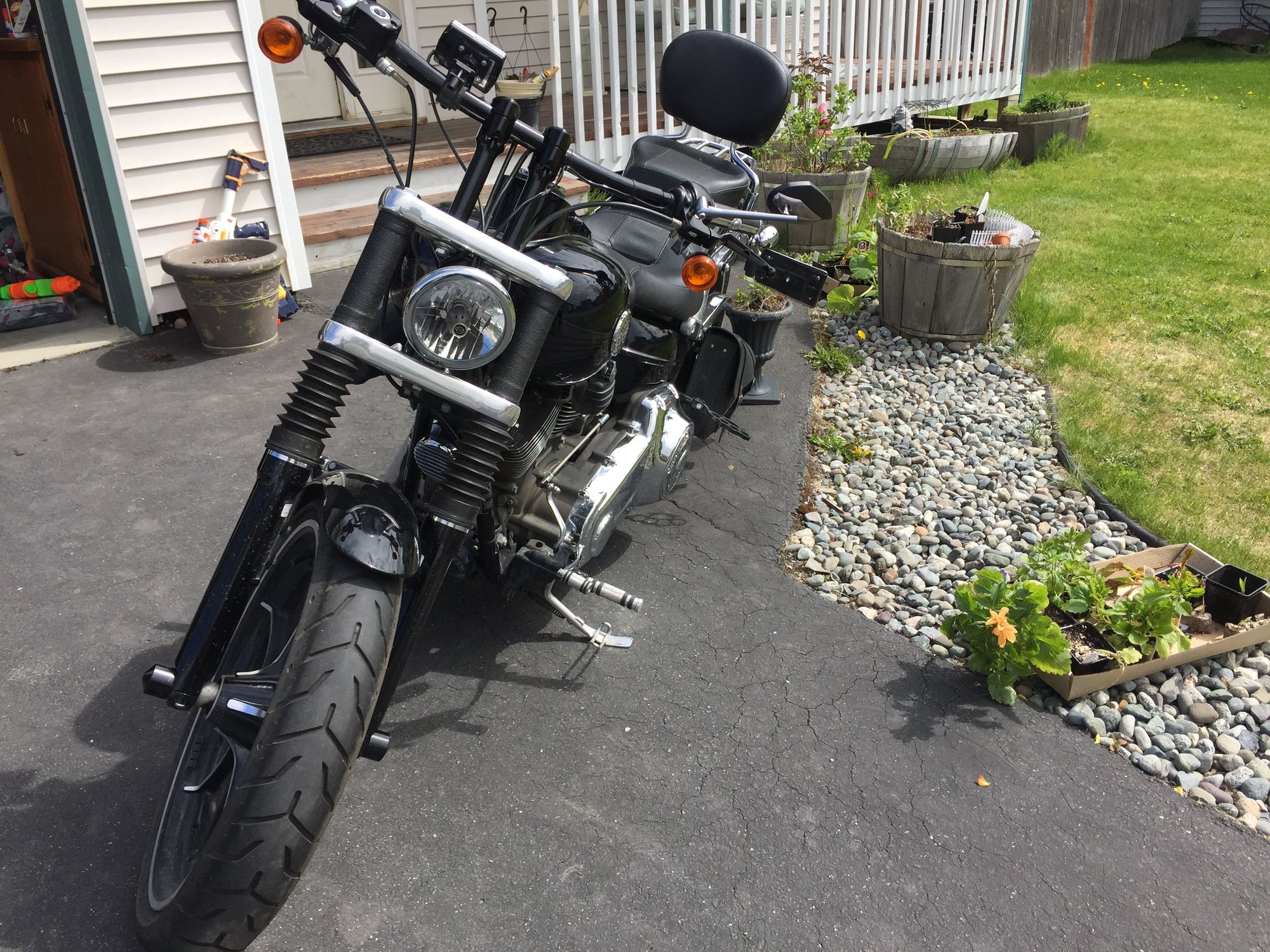

Put on 6" risers. Not sure if they are a tad tall. I have 4" ones on the way.
