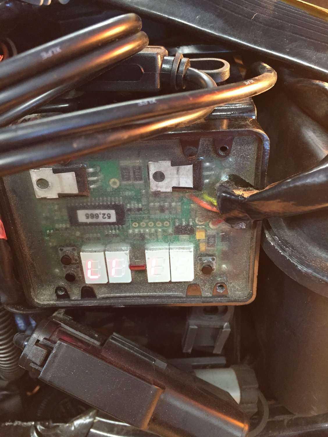

Purchased an 07 Nightster. Samson pipes. SE heavy air and this. No name on the outside. Digital display for what seems to be curve adjustments. Anybody point me in the right direction as to the make and manufacturer. Thanks. Gerry

Okay. Seems it might be a fuelpak. Any help or pointers to setting it up?

That's a fuelpak but I'm not familiar with it. Maybe someone will chime in but I would get on YouTube. Don't you need software on your computer for mapping.

it has a been a long time since I have dealt with a fuel pack and this one is missing the cover...but what you do is push the single button on the right (which is really on the left when it is right side up) to go though the steps and the buttons on the left raise or lower the values for each setting...you should be able to find what the different setting mean .. I think the first setting is idle mix that second mid mix and the 3rd high speed mix.. then there is a setting for cold running mix (choke) and a couple more which I can't remember.. go online and do a search you should be able to find the directions somewhere....what you really need to know is that it can only raise the values from the stock settings (if I remember right) so when you lower the number to zero in each category you are basically setting the mix to the stock settings..

try this for the setting and how to install them..
http://fuelpakfi.com/fplookup_new_re...=stock&class=1
