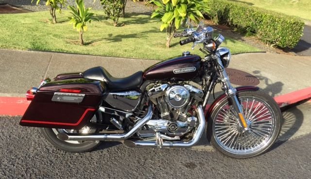

I have the burly's installed and they are pretty darn stiff. I would go with progressives but i'm short and like my feet planted firmly on the ground.
