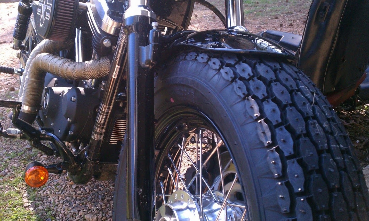

Old Mar 1, 2015 | 10:26 AM
Rog48's Avatar
Rog48
Joined: Aug 2011
Posts: 3,932
Likes: 45
From: Stockbridge GA
You can just see the washers in this pic, I think I used 2.
Ive got different forks and trees now so I dont use a fender any more.
Old Mar 1, 2015 | 11:02 AM
KeeBee's Avatar
KeeBee
Joined: Oct 2010
Posts: 1,038
From: Katy, TX
Thx for the info and pics most likely won't run a front fender. But good to know I can use it if I wanted to with washers.
