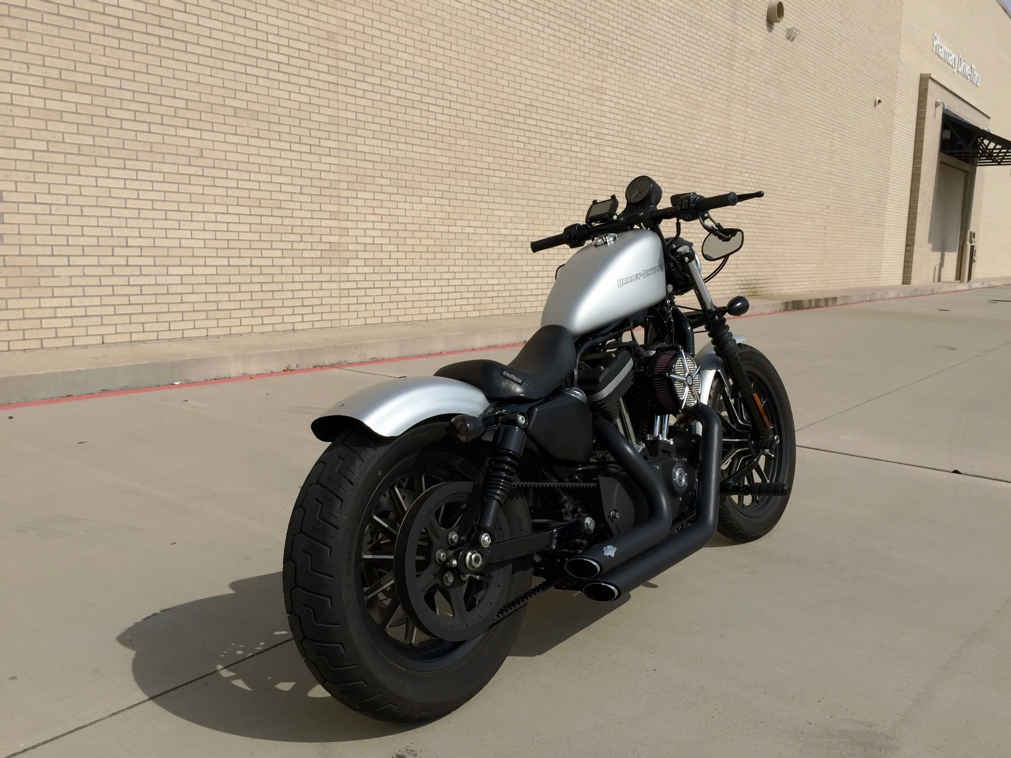

I like them, the ride is much smoother on my butt. Install was easy with a jack under the frame. I'll see if I have other install pics
Last edited by Granjour; Jun 2, 2015 at 08:23 PM. Reason: **sorry for the enormous pic

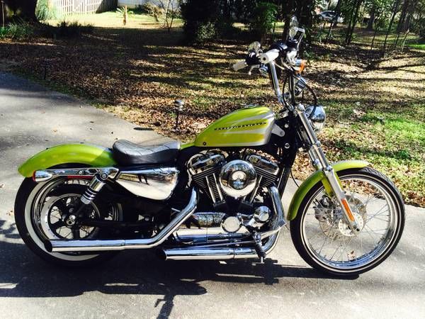

Here's my 72 with 10.5" Burly Slammers. They dropped it about an inch. My forks are stock. Better ride than the stock shocks, but very little travel. I don't mind though. Keep in mind that the stock shocks on my bike were 11.5" and yours are most likely 13.5" so you will see a drastic difference in height. Changing that much on the rear only may be a little more awkward than mine only going down an inch.

Great looking bike man!
