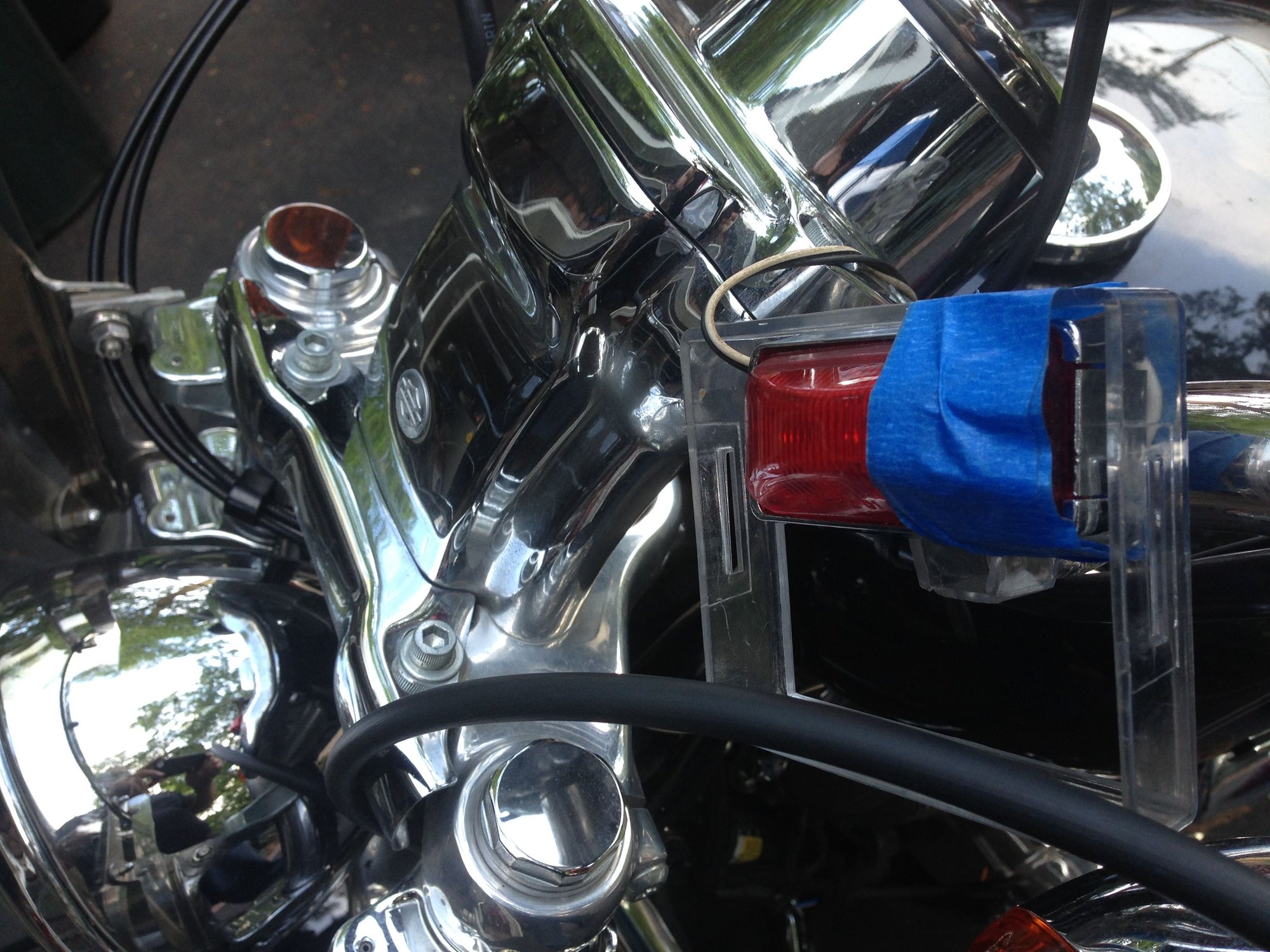

Having installed a Gear Brake gearbrake.com "smart brake light module (universal model $70) I needed to test it. The sensitivity is adjustable.
Problem: Can't see the brake light while riding
Solution: temporarily add a test light up front
Unused LED marker light taped into E-Z Pass bracket

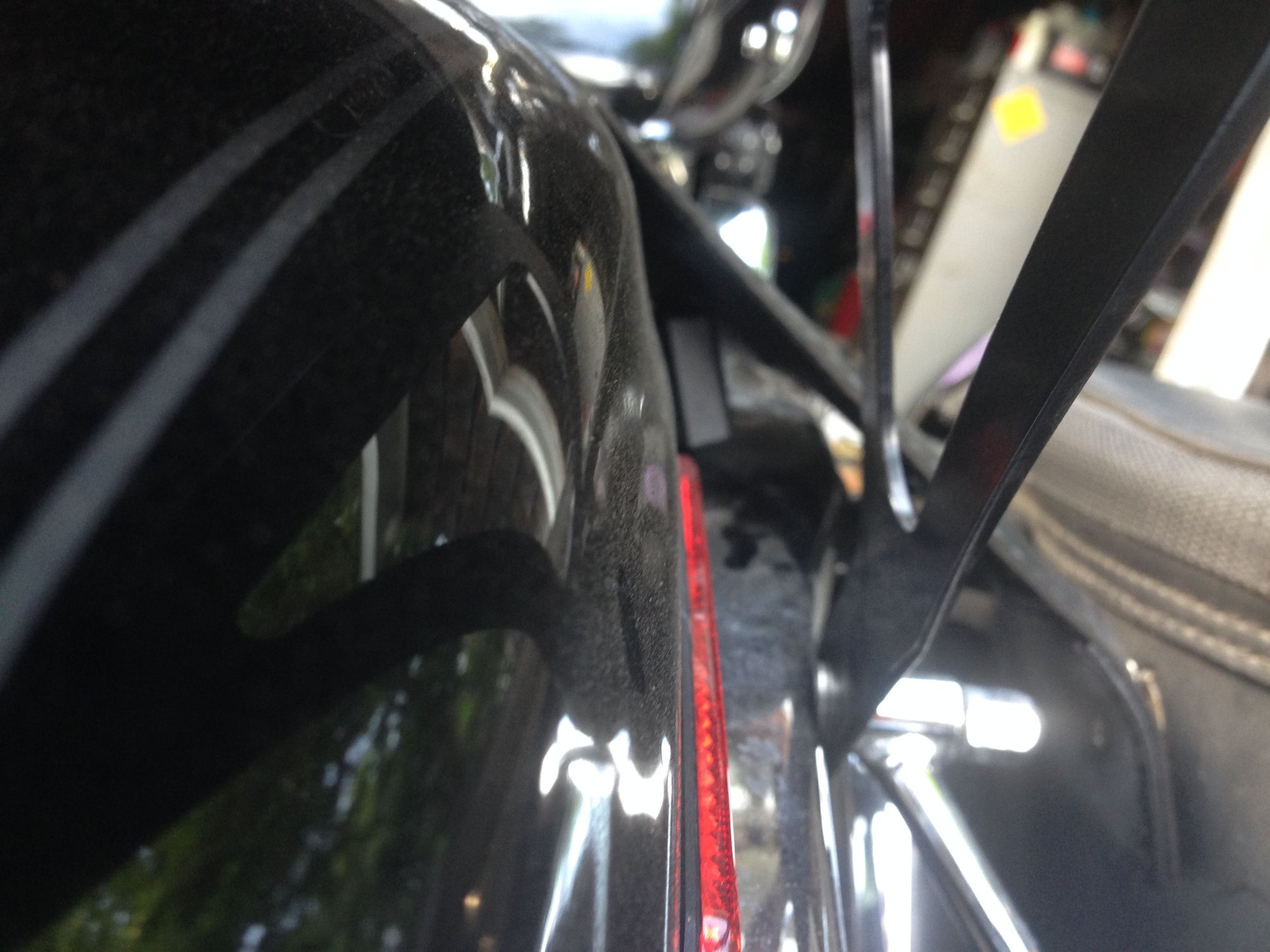

Gear Brake black box velcroed to fender under saddlebag yoke (above red reflector)
Wiring with 2 extra taps for test light (those get removed)
The unit works great! For example, cruising at 30 MPH in 3rd. Drop throttle and 3/4 second later the brake light flashes, then stays on for a while.
