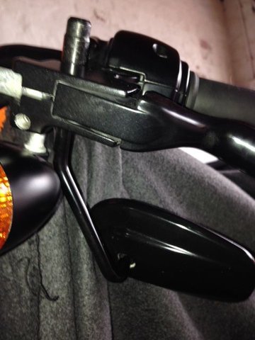

hey guys so i have no been shown kindly how to attach photos ...
so the clutch lever I'm guessing the previous owner was leaning on it , and the bracket seems to have opened up....
can i just grab som rags , and a C camp and tighten it back to original state? not much movement is needed , just a tad wobbly

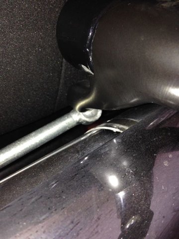

the foot break connects to a rod behind the pipes , can i tighten this with a set of allen keys ? i like my ride solid as possible , but don't wanna play with **** i don't know hahaha
its just where the foot pedal connects via a small "pivot cup " what do i need to know?

The "pivot cup" is called a Heim joint. It's a press-fit, ball-and-socket arrangement that has a plastic socket inside the metal. Look at it. You'll see it. While it's entirely possible for the joint to wear out, I don't hear about it very often, unless it's gone a while without a little oil or the bike is stored outside (then, the joint can become sticky but not really wobbly). I believe the proper tool is a Torx bit, not an Allen key, for the ball-stud. A Torx tool, shaped like an Allen key, is most useful for that application.
