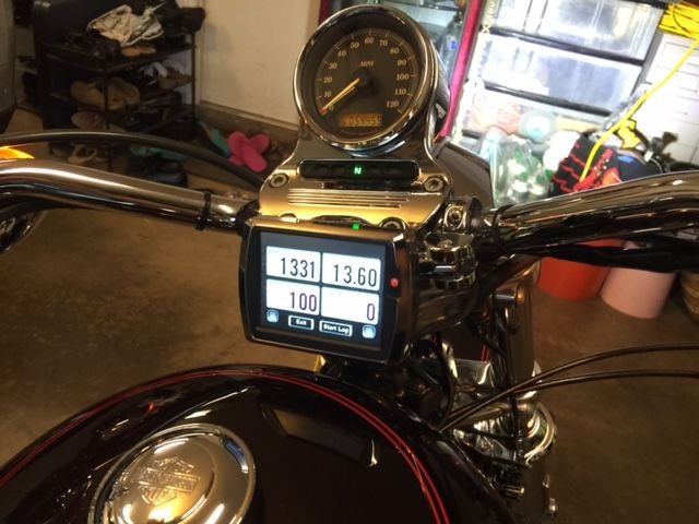

I also use my unit as a gauge to monitor engine temp, rpm, voltage, and gear (there are many other things you can monitor). I had a HD digital gear indicator on my bike before I got the autotune and that alone cost me over $200. Here is a pic of the unit gauge feature. You can also change the view to the analog/dial type if you prefer.
