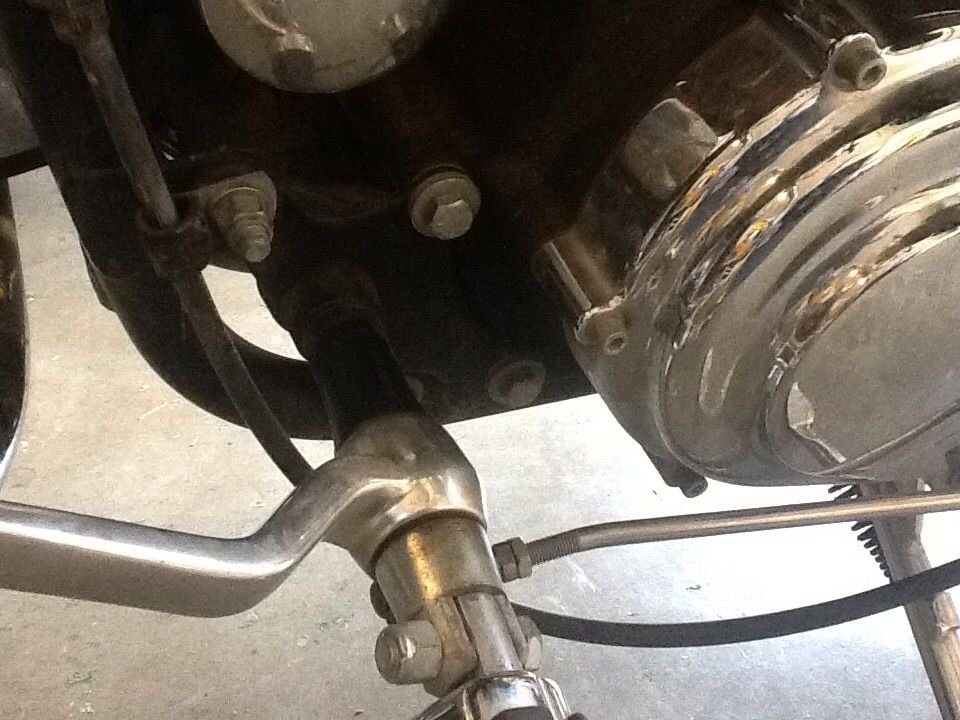

Lol I was gonna send those brackets too but I guess that is the motor mount? But here is what it looks like.

Default Forward install question
Ok. Looks like I'll just need those extensions going into the motor mounts.

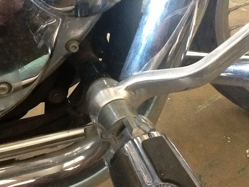

That brake side is hard to tell from the pic. Is there a piece going into the motor mount. Or is it all one piece. If it's all one piece I'll need that motor mount.

When you go to forward controls, you will be changing your front lower motor mounts, both sides. The new ones are beefier to support the controls. Your highway pegs will be gone.
