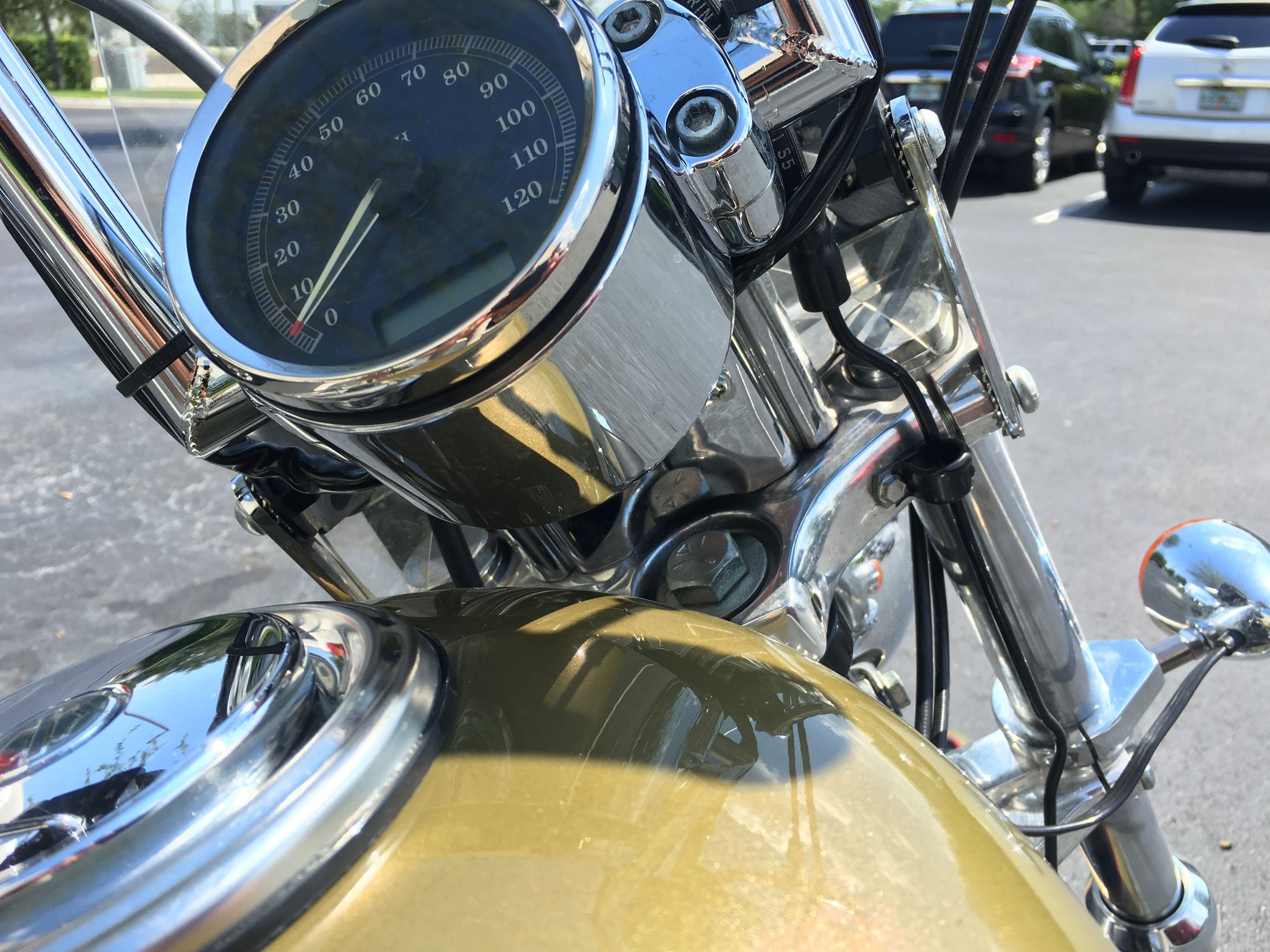

Just in case someone finds this post in the future, here are some pics of my 1" lift. I used a pair of square spacers that came with a TV wall mount.
DIY lift with cover back on
Tank clearance
XL1200C 1" tank lift
Lift with cover off
