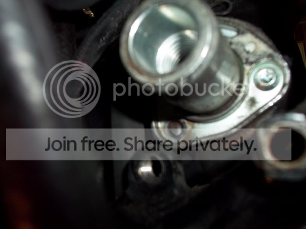

There's a fairly common issue on rubber mount XL's with some bolts shearing at the rear isolator mount, causing instability and wobbling. I haven't heard of it causing vibration under load, but it might be worth checking ...
Not my pictures, they came from a thread on the XL Forum.
