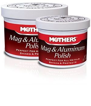

http://www.mothers.com/02_products/0...ml#&slider1=20

Thanks. I know there are quite a few products out there, I was looking for someone who has used the product that can back up the manufacturers doings

.............. i didn't just google it and post it, good sir
on my sliders
on camcase, pulley cover, pulley lip, primary, rocker box covers, triple trees, and wheels
i also used flitz metal polish in the wheels and sliders.
the sliders were wet sanded from 400 to 800 to 1000 to 1500. then flitz. then mothers. nice mirror finish.
not really what yoiu want for your cases/covers though

I've also used Mother's, with good results, but it does take a lot of polishing. As John Harper mentioned above, there may be clear coat which needs to be removed. I had a 1989 a while back, and used a Marine Stripper that I got locally at a paint store, and did my rocker boxes and fork sliders. It melted the clear coat right off. Mine had the cracks in the clear coat, with the white corrosion underneath where moisture and air gets in. It came out nice, but took a lot of elbow grease. I'm sooo glad my '06 is all chrome.
There is a round foam rubber ball that is available that can be used in an electric drill for polishing large flat areas. I tried it, and it works, but it does fling polish around, and there are still areas that you have to do by hand. Good luck.
