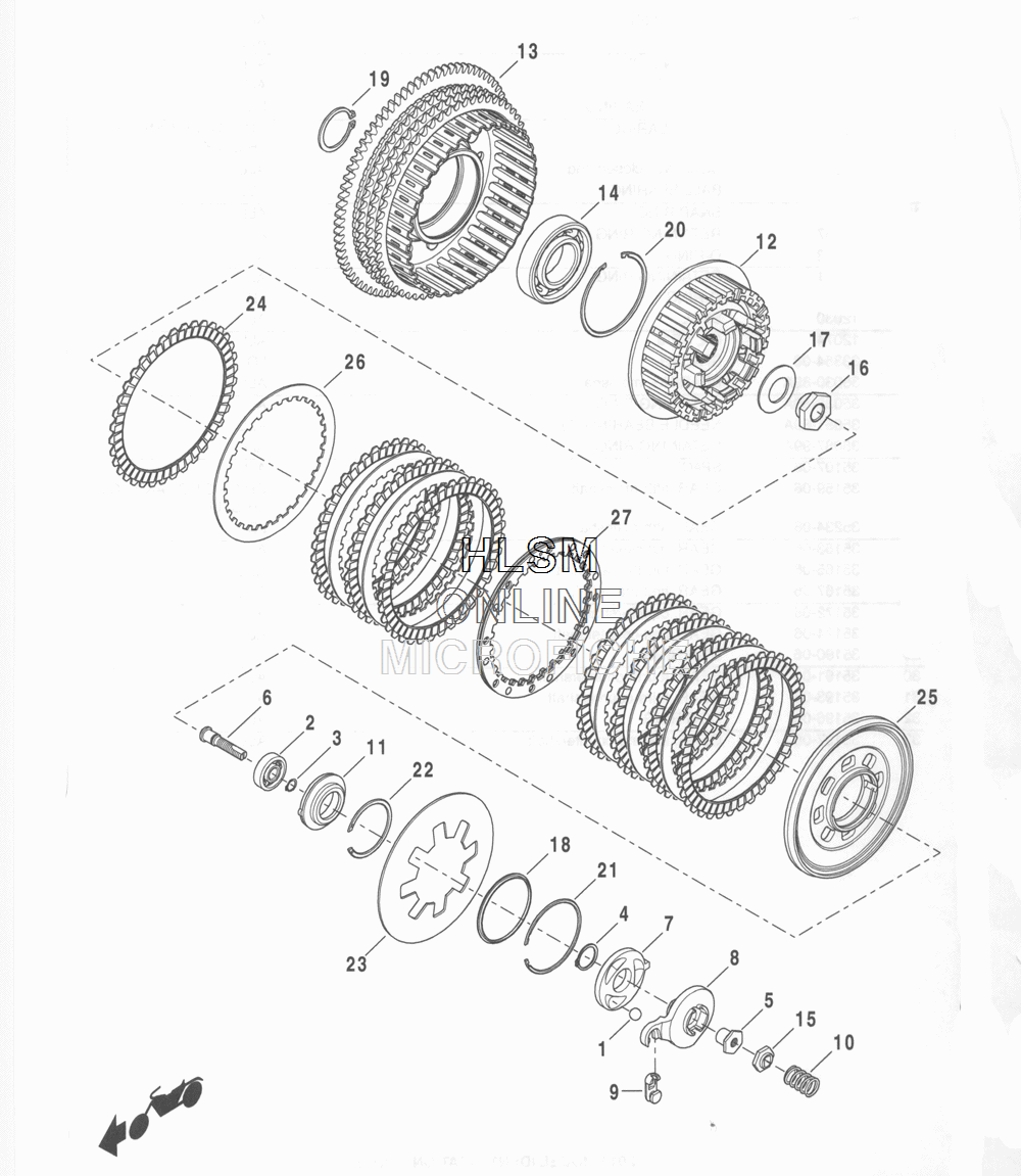

The Clutch plate kit I linked, 37980-10, includes the friction and steel plates to replace the stock ones including the "spring plate". You would use your original clutch diaphragm spring.
The other SE Clutch kit, 38002-04, also includes a 10% higher rate clutch diaphragm spring.
http://www.harley-davidson.com/store...nce-clutch-kit
Kit includes KevlarŽ-based friction discs and performance clutch spring
Both kits will replace the original clutch "SPRING Plate" with a friction and steel plate.
The Stock clutch has 6 steel plates, 8 friction plates and 1 spring plate with a diaphragm spring.
Code:
23	  37924-04A	  SPRING, CLUTCH PLATE	                1
24	  37911-90	  FRICTION PLATE (PAPER)	        8
25	  37912-91	  PRESSURE PLATE	                1
26	  37913-90	  STEEL PLATE	                        6
27	  37977-90	  SPRING PLATE	                        1
