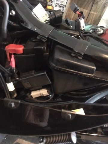

On my bike, the connectors are different under the seat (custom Dynamic module connector in left of my hand, my bikes wire on right):
so the Custom Dynamics module doesn't fit.
I'm thinking the wires must be in some other location. I checked behind the left battery panel but didn't see anything to connect to:

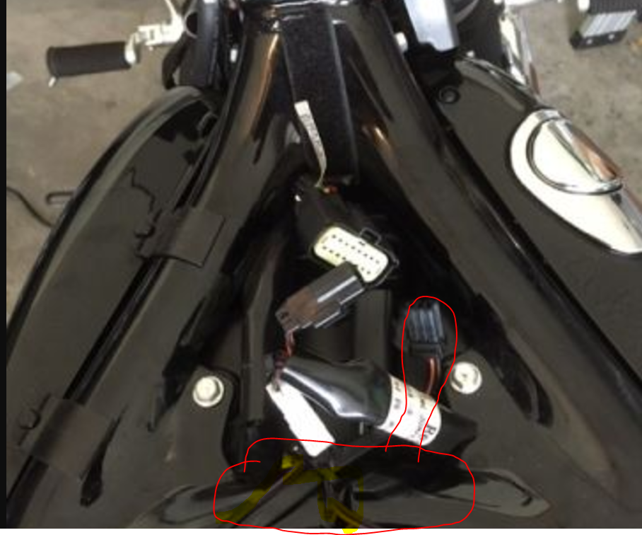

Under the seat.
there is enough room to stack the modules under the wires.
load balancer patched inline before the triple play

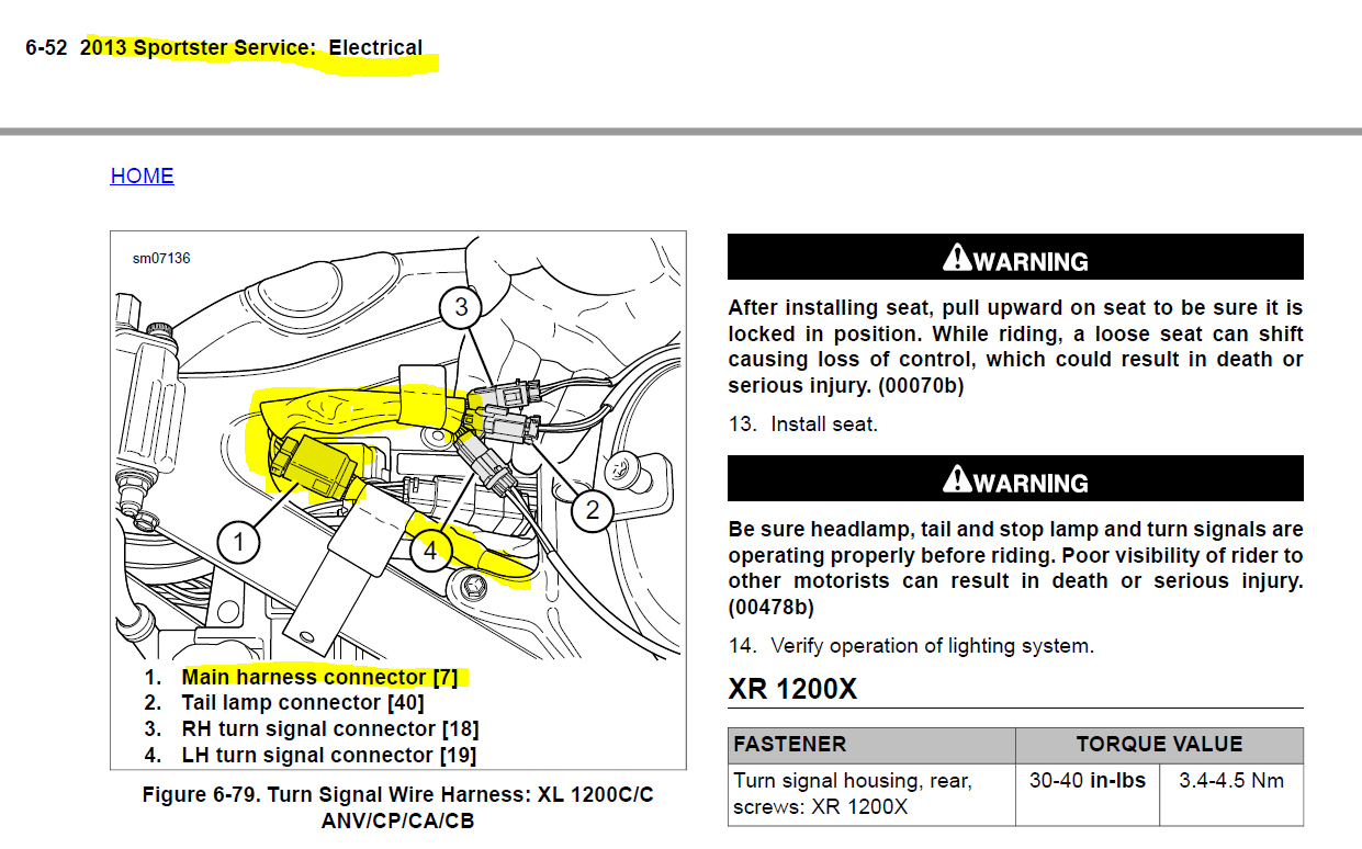

pull them all. no changes till 2014.
may be under those you are seeing. let me dig some

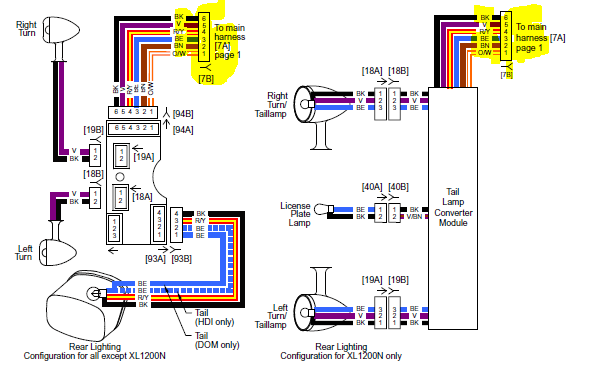

confirmed:
follow the wires coming in from the turns and brake light.

theres space... just tight... watch out for spaces that will cause pressure on the modules, they will break and short out.
