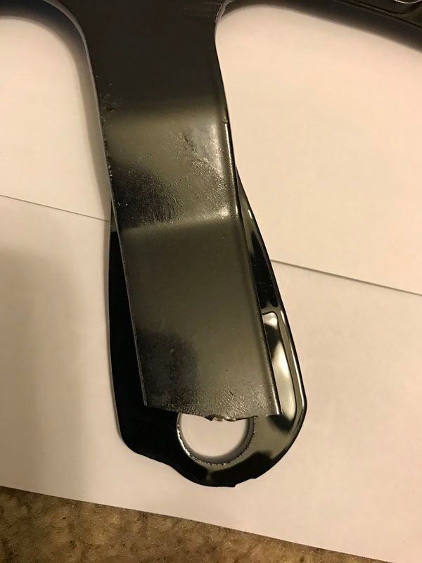

I broke the original one on my 2013 XL1200C-
2013 xl1200c (my Bike)
60367-04 BELT GUARD 1 67.49
Looking at the new models in the showroom I noticed the mounting point looked different than mine and found this updated part number-
2016 1200C
60367-04A BELT GUARD 1 67.49
I also liked the looks of the 48 and Iron 883 belt guards
2016 Iron 883
60379-09A BELT GUARD 1 94.99
Buckshot round holes?
2016 48
60300115 BELT GUARD 1 75.99
Slotted
I ordered the 60300115 part number to get the slotted belt guard instead of the XL1200C stock solid belt guard.
Hopefully the photos below will show the differences (other than the slots in new one )
The old broken belt guard on top of the new one showing the rear mount point being wider:
The new belt guard showing where the bend is located :
The original belt guard showing the bend for the mount (it broke at the top of the mount point hole behind the rear shock mount)

I recall one other thread on this guard breaking.
Updated part may have found the weakness.
Look to misalignment....belt or bolt hitting the guard, belt guard tabs on swingarm bent, passenger foot kicked the guard out of alignment, tire change issues. etc.
Hoping the upgraded part was the cure!
