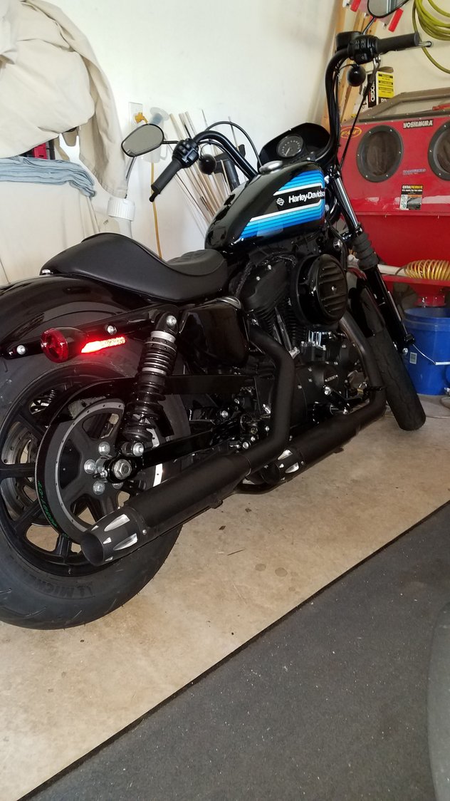

Wanted to make my 2018 1200 Iron sound alittle better. Just could not take my bike sounding like a pissed off lawn mower any more.
I did not have alot to spend so I took a chance on the $100 DNA slips for now. I was really surprised to find the cats located in the stock mufflers. DNA slipons went on good, but the bolts that came with them were alittle short. Had some 1/4 longer 3/8 bolts on hand so no problem.
not a big fan of the entire exhaust system look, but at least it sounds like a Harley now.

I could feel a difference in performance. Its nothing spectacular but it is noticable. I have a grade to go up on my way to work, its always been a 4th gear climb if I wanted to stay at 65 - 70 mph. Now it will do it in 5th no problem.
these same slipons go by a few different names on ebay.
